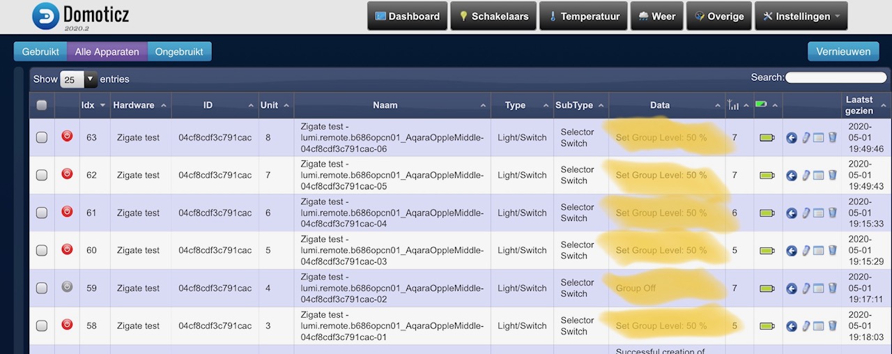

I mean this bug:pipiche wrote: Saturday 02 May 2020 10:49 I don’t understand what you mean by cosmetic bug left.
The signal strength is an expected behaviour.
For pushing to stable, there no plan for now.
in the settings -> device page I see different selections like Group on, Dim 20%, group off etc. In the widget it is click, double click etc.
See attachment.
- F18302BD-B172-4063-A3A0-3ECC0AC97851.jpeg (193.47 KiB) Viewed 797 times
Re: Zigate and Aqara Opple switch
This is how Domoticz behave ... so cannot do more.
