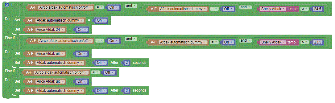

Hello
i have also the h&t from shelly here works it great
see picture
Gerwin
see picture
Gerwin
- blockly shelly.gif (75.76 KiB) Viewed 817 times

hello gerwin
everything is working now.... i think domoticz-shelly H&T needs a learning process when connecting
when for example i change the name of the shelly H&T it takes some time to update the name in blockly
thanks for your reply
