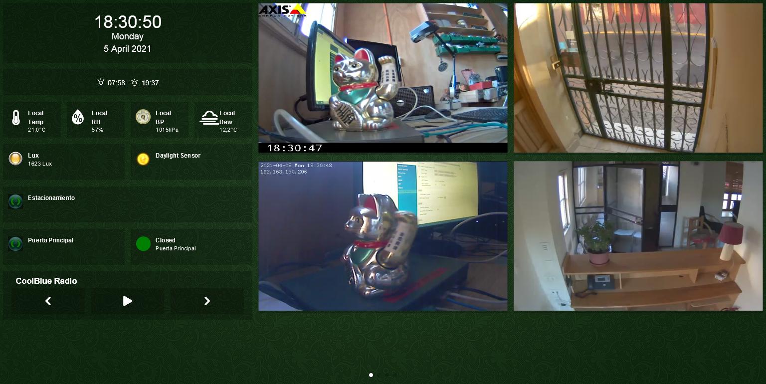

This inspired me to try another way to get live video into Dashticz.
Got a couple of H.264 640x480@15 fps cameras displaying in IFrames on Dashticz easily enough when I used Shinobi to re-stream them using the HLS (http live streaming) protocol. The results were quite impressive, the total bandwidth was around 1.5-2 Mbit/s and the video was smooth and continuous.
I was quite pleased with this until I noticed the up-to 10-second lag, due to the way that HLS transmits data in chunks. That's fine for watching internet video clips, but for real-time video surveillance it's no good - a lot can happen in 10 seconds.
Update:

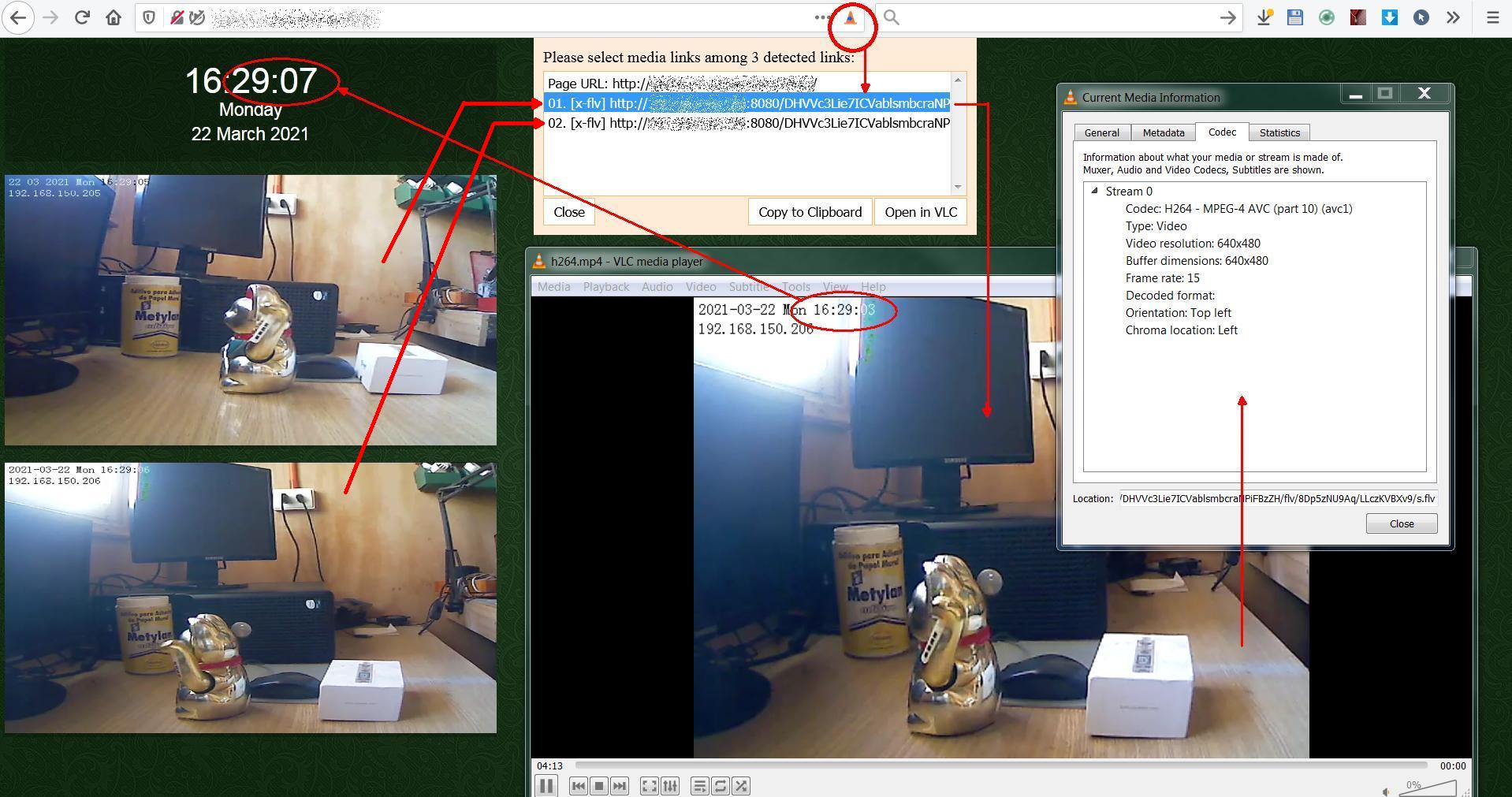

Later on discovered that Shinobi can stream flash video (flv) using the source codec, in this case h.264. That worked, so currently have two cameras running in IFrames in Dashticz, no CORS problems. The latency is around 2-4 seconds and the total bandwidth they use is around 800 Kb/s.
The Shinobi and Dashticz servers run on a separate Pi 3. The Pi 4 client itself now has to work harder, with a load average between 0.8 and 1.8. Also had to tweak various settings in Chromium to display continuous video. So far they have run 24 hours, surviving the periodic Dashticz reloads. So this works, but I think that simultaneously displaying more cameras would be "a bridge too far" given the Pi's limitations. Maybe Camera Buttons as used by the OP would be a solution.
Here's Dashticz in a Firefox browser using the "Open in VLC" plugin for analysis. The Lucky Chinese Cat provides continuous motion for testing.

At the risk of turning this topic into a diary, one final post: A Pi 4B will work with 4 cameras via Shinobi, simultaneously running h.264 at 640x480@15fps in Iframes without too much strain. However, Browsers are not especially suited for live camera streams, and with discontinuities through, for example a weak wifi network connection, they will start to buffer the video, introducing latency which persists until the URL is refreshed, not so good if live viewing is what you want. This wasn't a problem with a wired LAN connection.
The Chromium browser used also required various tweaks to avoid caching and to allow streaming even when Dashticz was in standby. Both it, and Firefox don't allow audio autoplay any more, so even though these cameras weren't streaming audio, more tweaks were needed to get them to run.
Although it's working, and looks as if it will stay that way, its probably more trouble than its worth - after all there are dedicated cctv applications that do a better job.
Dashticz 4cams.jpg (144.05 KiB) Viewed 3367 times
Update, some months later: Ended up streaming 4 cameras using Shinobi with Websocket connections for low latency. This Pi3 server is still running, but a Pi4 version currently being built shows much better performance, and was tested with 6 cameras, but could run more. External plus manual triggers were used to pop up individual cameras in the final version.
