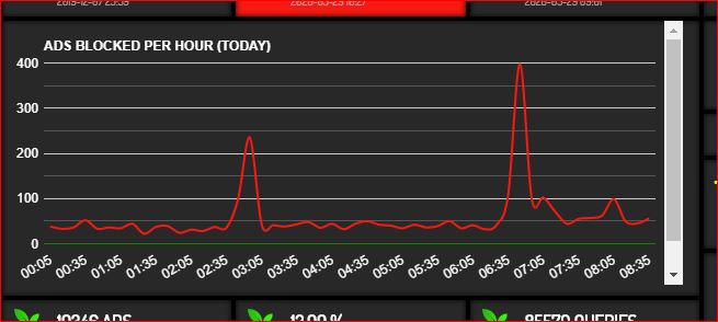

Hi, just updated my old Dashtics to 3.4.1 (beta)..
Everything works just fine, but the iframe parameter: scrollbars does not work.
Using following code:
frames.pi_hole_grap	= {
	width:12,
	height:255,
	refreshiframe:300000,
	frameurl: 'php/grap_pihole_today_quieries.php',
	scrollbars: false
Am I missing some config setting?

Minglarn wrote: Sunday 29 March 2020 10:48 Hi, just updated my old Dashtics to 3.4.1 (beta)..
	width:12,
	height:255,
	scrollbars: false
hmm, it's working on my system.
Can you try scrollbars: true and scrollbars: false with the following block:
frames.weather = {
    refresh:300,
    height:130,
    frameurl:'http://api.buienradar.nl/image/1.0/RadarMapNL?w=360&h=300',
    width:12,
    scrollbars: false
(In your block don't forget to change refreshiframe:300000 to refresh:300)

Unfortunately the same result...
    refresh:300,
    height:255,
    width:12,
    scrollbars: false
Lokonli
