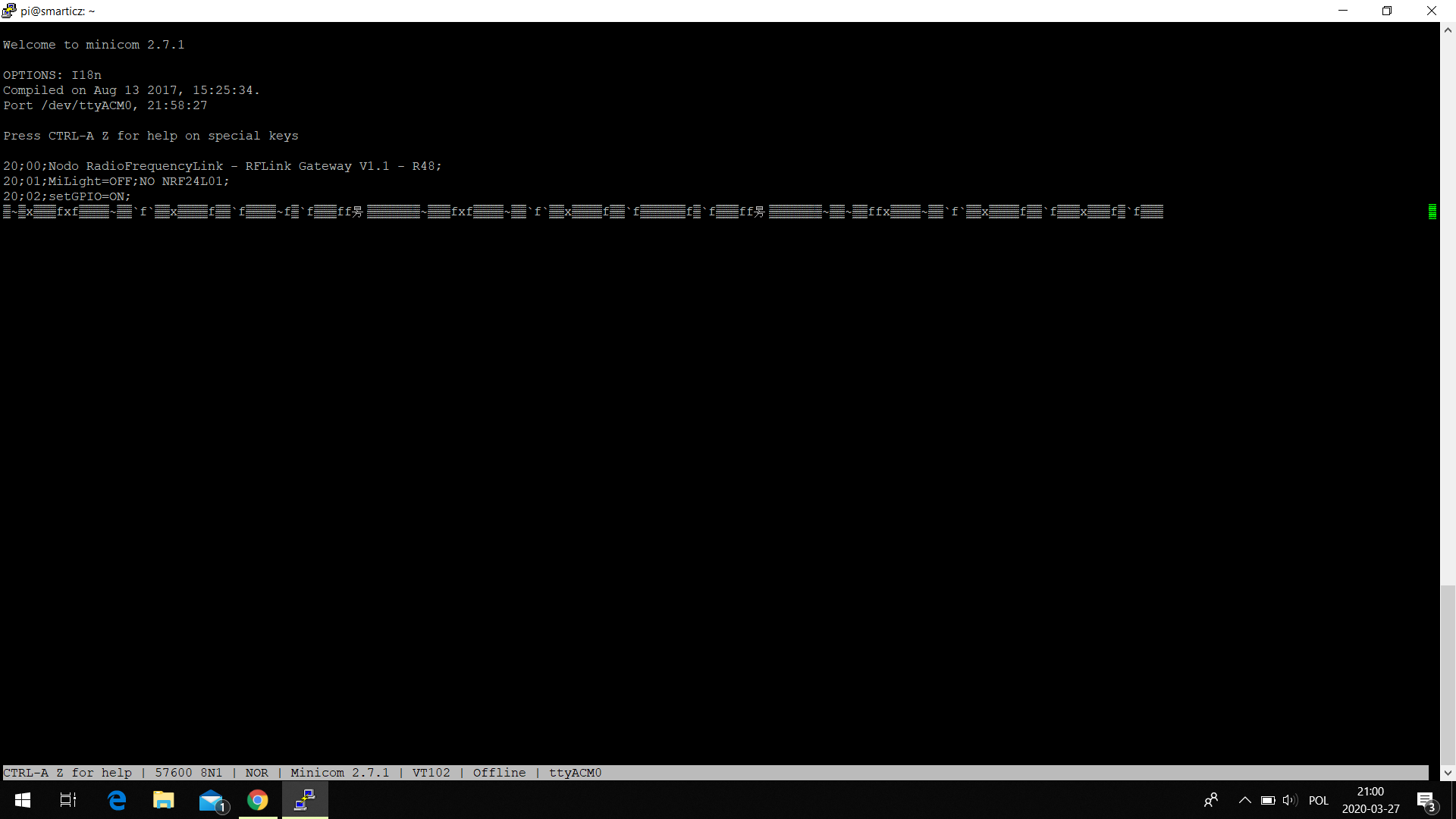

So if I press the remote I can see received signal. But i think due to language is set to Polish i see only small windows mixed with "f"sancla wrote: Friday 27 March 2020 21:40 Well, with that, you can actually read the raw data from the RFlink on your pi. That way, you know that it's either a hardware/Operating system issue or something in Domoticz.
But signal is received by rpi
Re: Rflink not adding new devices in Domoticz
It's good practice to keep backend systems in English. That way, you have better community support.
But for now, it's hard for me to help you with that info. Could you perhaps send a screenshot or photo, perhaps we can make anything of it...
See attached screen shoot. I really dont know how to operate in Linux so I have also run the test through RFlink loader.
20;08;RFUDEBUG=ON;
20;09;Keeloq;ID=4dc2;SWITCH=04;CMD=ON;BAT=OK;
20;0A;DEBUG;Pulses=82;Pulses(uSec)=330,300,240,330,270,300,270,330,240,330,270,300,240,300,240,330,240,330,270,300,270,300,240,3750,270,690,630,330,270,690,270,690,630,330,630,330,630,300,240,690,240,690,630,300,240,690,270,690,240,690,630,330,240,690,240,690,240,690,630,300,630,330,630,330,270,690,630,330,630,330,630,300,270,690,630,300,630,330,240,690,240,690;
20;0B;DEBUG;Pulses=124;Pulses(uSec)=300,300,210,300,210,300,240,300,240,330,240,330,240,3750,240,720,630,330,240,720,240,720,630,330,630,330,630,330,240,720,240,720,630,330,240,720,240,720,240,720,630,330,240,720,240,720,240,720,630,330,630,330,630,330,240,720,630,330,630,330,630,330,240,720,630,330,630,330,240,720,240,720,240,720,630,330,240,720,630,330,240,720,630,330,630,330,240,720,240,720,630,330,240,720,240,720,240,720,630,330,630,330,630,330,630,330,240,720,630,330,630,330,630,330,630,330,630,330,630,330,630,330,210,6990;
20;0C;DEBUG;Pulses=128;Pulses(uSec)=30,420,240,720,240,720,600,330,600,330,600,330,600,330,600,330,240,720,630,330,240,720,240,720,240,720,240,720,240,720,630,330,630,330,240,720,630,330,240,720,240,720,240,720,630,330,240,720,630,330,240,720,240,720,630,330,240,720,240,720,630,330,240,720,630,330,630,330,240,720,240,720,630,330,240,720,240,720,240,720,630,330,630,330,630,330,630,330,240,720,630,330,630,330,630,330,630,330,600,330,630,330,630,330,630,330,630,330,630,330,630,330,630,330,630,330,600,330,630,330,630,330,240,720,630,330,630,6990;
20;08;RFUDEBUG=ON;
- Bez tytułu.png (69.15 KiB) Viewed 3036 times
Well, first thing I notice in the screenshot is that your RFlink is still on firmware R40, latest version is R48.
Second, it is strange that first you get a clear ASCII responses followed by some gibberish.
Try to update your RFlink firmware to the latest version and see if that helps. Also, you could share this info on the RFlink forum, could be that the problem is not related to Domoticz...
The other results except the screenshot you posted seems to be fine.
