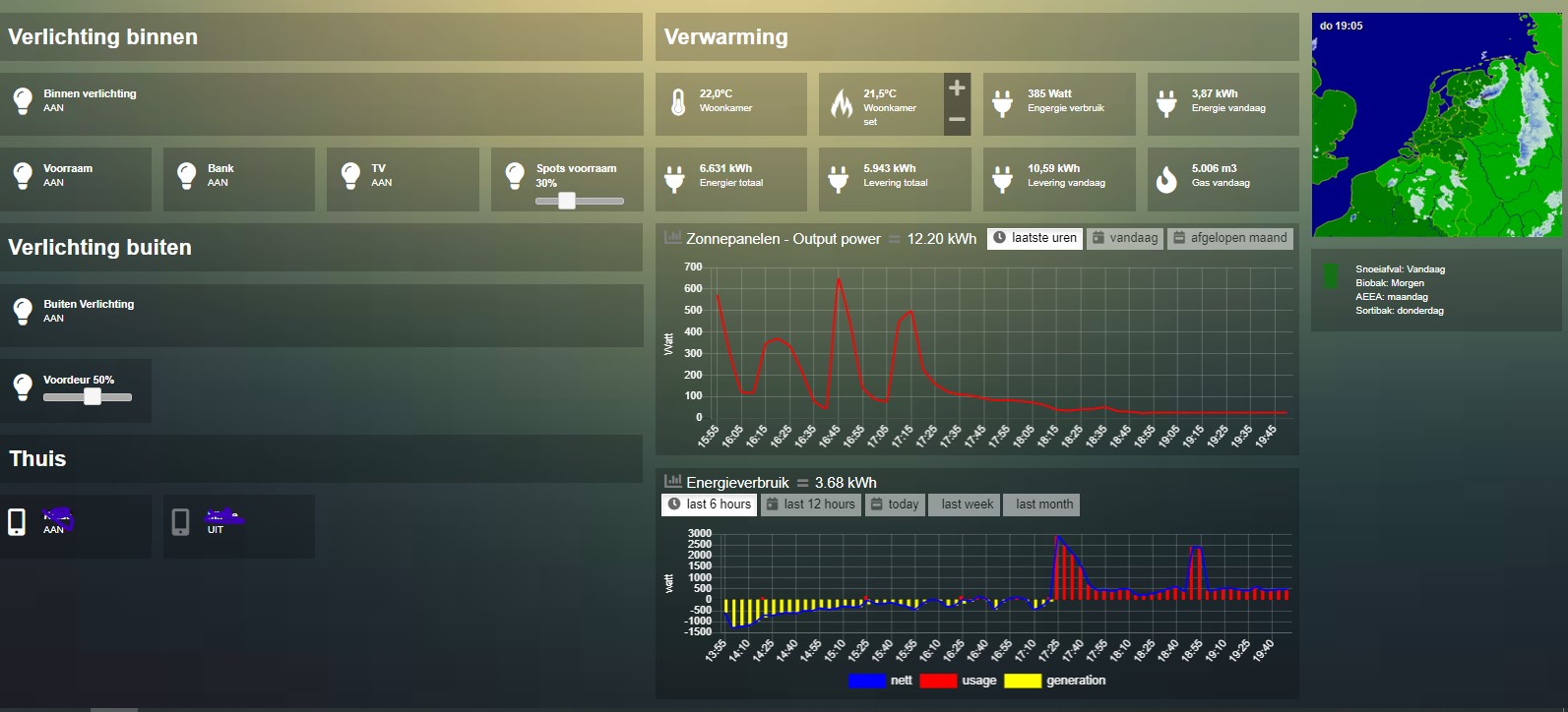

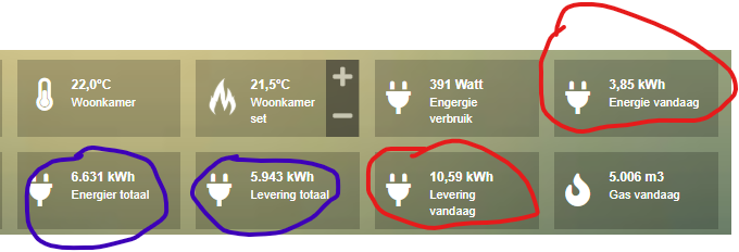

i got a nice dash whit dashticz but now i got a question.
can i make a custom block where i make a calculation of the usage and return from the p1 meter
i already got the graph whats does that.

and if this works i wold make a block of the real power usage (usage- return + solar)

There isn't anything at present that can achieve this in Dashticz. But I believe it maybe on the 'not too distant' roadmap.
In the meantime, you can create a dummy sensor in Domoticz that performs the calculation, then add that as a separate block in Dashticz.
