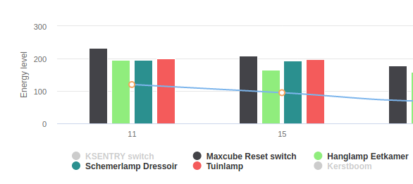

Edit: added energy scan picture

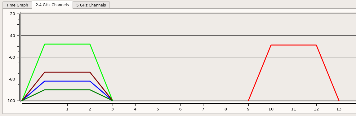

My Wifi channels, Zigbee channel 15 should be between wifi channel 3 and 4 so in my case there is a little bit overlap from a device running on Wifi channel 2

The device ("Schemerlamp dressoir") that dissapeared this evening at approx 18.09 hr was yesterday afternoon just fine according energy scan

As a reference the Wiofi/Zigbee channel drawing

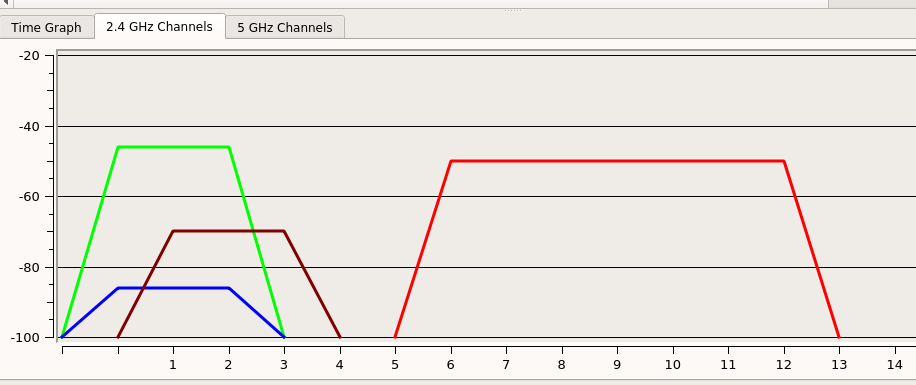

Moved one AP from channel 2 to 1, see what happens. The other 2 bulbs of the same group I also lost this evening. They all switched off as group on 22.30 as programmed but when switching them on again manualy a half hour later only the bulb I repaired earlier this evening reacted. The other 2 NACK-ed again and I had to power switch them off and on again te reconnect.

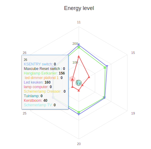

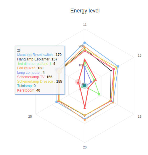

I also have made some energy scans the last days and see that the energy levels are dropping:
first scan
first scan

last scan
last scan
Screenshot from 2020-02-25 19-01-15.png (47.99 KiB) Viewed 1246 times

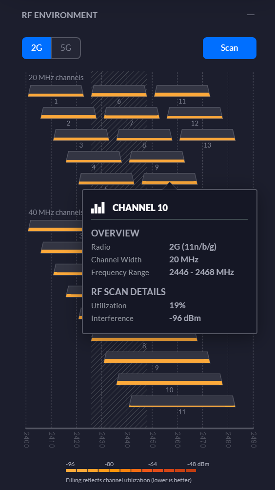

WiFi interference.png (62.73 KiB) Viewed 1212 times
with -96dBm interference on all channels, what's very low in my opinion. I now have 2 zigbee networks, on channel 11 and 25 with WiFi on channel 6 in between to have the least possible interference. The network on channel 11 will be setup as new network on channel 26 and then the Wifi channel is going to move to channel 1. But first i want to be sure on what firmware i'll set the Zigate.
