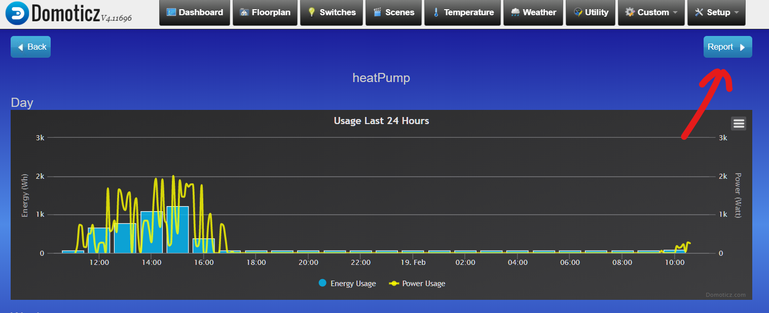

If you go to log page of the target device you will see the graphs and have the option to run a report (top right corner). Sometimes you need to refresh the page first (CTRL r in Chrome) before the graphs / report shows.
Heatpump graph.png (215.89 KiB) Viewed 3313 times

I do not know how to put images in this forum. Then I could show you how my graph looks like. In the day view you show here between 12.00 and 16.00 you see some blue bars. I have the dotted yellow line (power generated) but the blue bars are all zero. In the week view Wednesday shows the accumulated value correctly. After some time it started to appear again. So problem solved. Thanks for that
