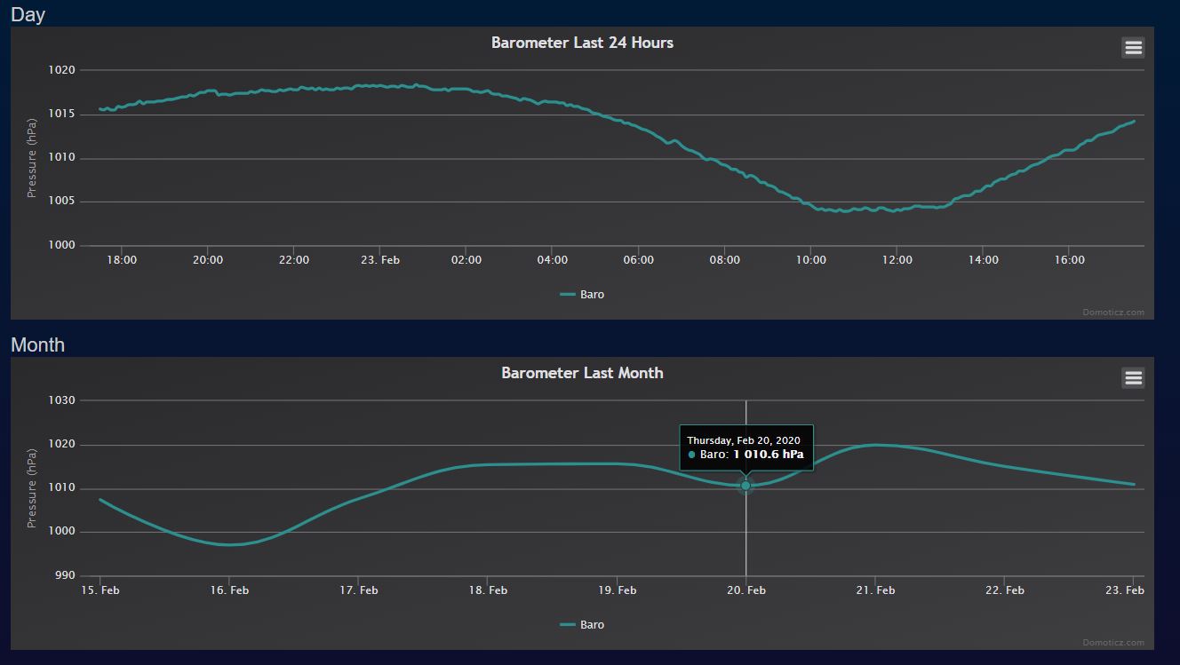

Gravityz
Posts: 652
Domoticz version: 2025.1
Re: script to predict storm  [Solved]
Post by Gravityz »
Tested it (we had a storm again in the netherlands)
works perfectly
it sends out a message through telegram when there is either a drop in pressure or a rise(both create hard winds)
i raised the delta for the 3hour measurement to 4.
i also noticed that when you have a big drop within the hour you get storms as well
However it makes no sense to detect this because by the time you get the warning you are already experiencing the bad weather.
