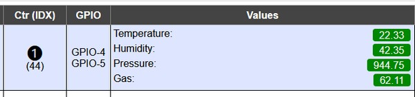

with the help of one ESP8266 and ESPEasy, I have access to the component BME680.
On the ESPEasy console I see all 4 values.
SUPPORT BME680.jpg (19.63 KiB) Viewed 1025 times

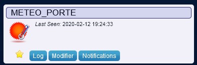

But not on DOMOTICZ Temperature windows box.
SUPPORT DOMO BME680_2.jpg (13.08 KiB) Viewed 1025 times
The debug show me:
Error: EventSystem: TEMP_HUM_BARO missing values : ID=44, sValue=22.12;43.31;944.75;62.49
Many thanks in advance for any help

for that you must use ESPEASY rules to send value, and create virtual device on Domoticz.
Question how did you integrate BME680 on ESPEASY, can you provide me firmware ?

For TEMP_HUM_BARO, Domoticz is expecting 5 values: https://www.domoticz.com/wiki/Domoticz_ ... Fbarometer
You should pass svalue=Temperature;Humidity;0;Pressure;0
