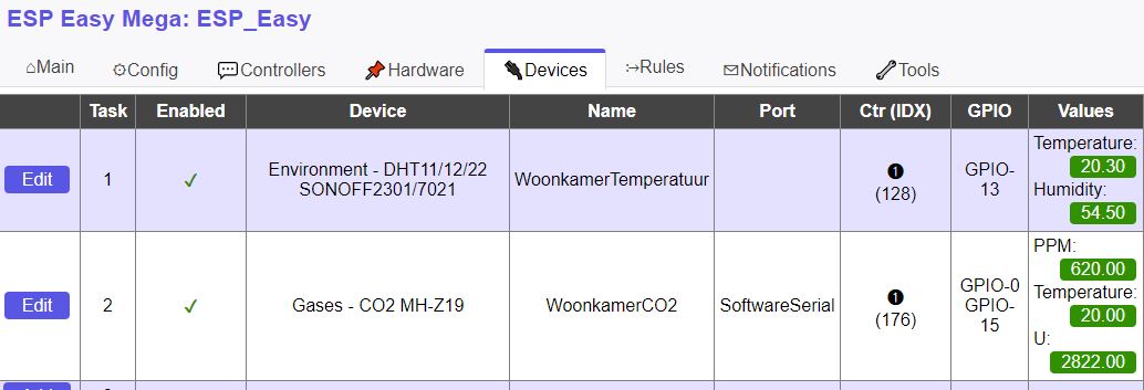

I am running a Wemos D1 mini with ESP Easy
Connected are a
1. DHT22
2. MH-Z19B
Both are connected on the 5V (of the Wemos D1 mini)
When running the DHT22 alone , the temperature reading is about 1,5 - 2 degrees Celcius higher , opposed to when I connect the MH-Z19B.
When i read the voltage values. With a normal multimeter, there is not much of a difference and if that was the issue. I would expect, one of the devices not returning a value. Now i added a Formula in Easpeasy to adjust it a bit more to the expected value, but that is not really the solution i would say.
Any ideas?
