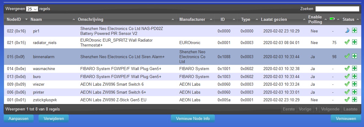

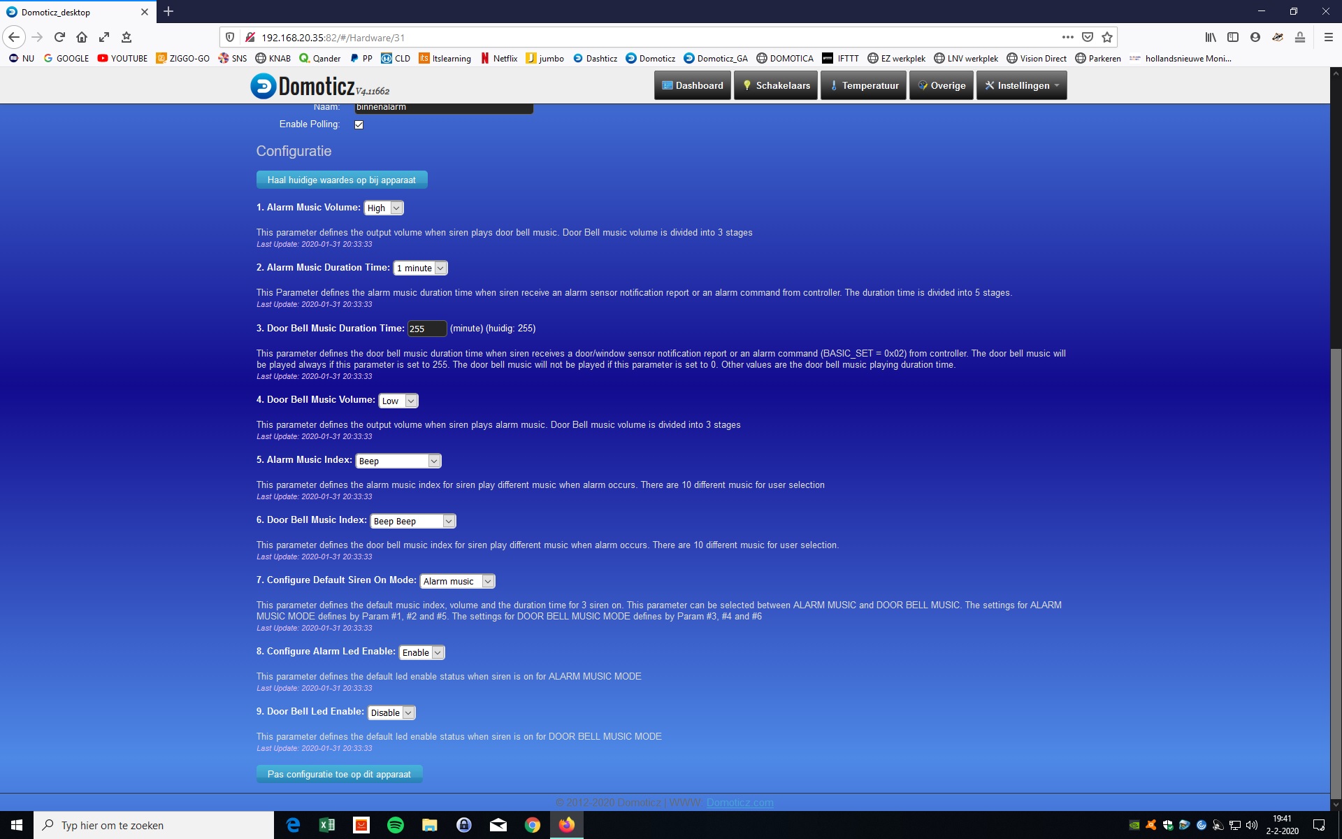

1. In my function i use the idx off the zwave device, i use 7 for the idx and 7 is also the id off the parameter in the zwave siren.
When you look at my zwave config (see attachment, you can see that my zwave id =15, how is that possible, that this even works!?

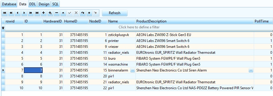

Strange thing is the id of the zwave, i changed my first post (did not saw your reaction in time..)
To make this work i must use the domoticz id of the zwave device and not the id that is shown in zwave itself.
Would be nice if domoticz also shows this ID so i dont have to look in the database instead...

can i delete the id's of the zwave devices in the database that are not shown in domoticz zwave screen?
Feels not ok that i have two entries for my pir and two for my radiator...
