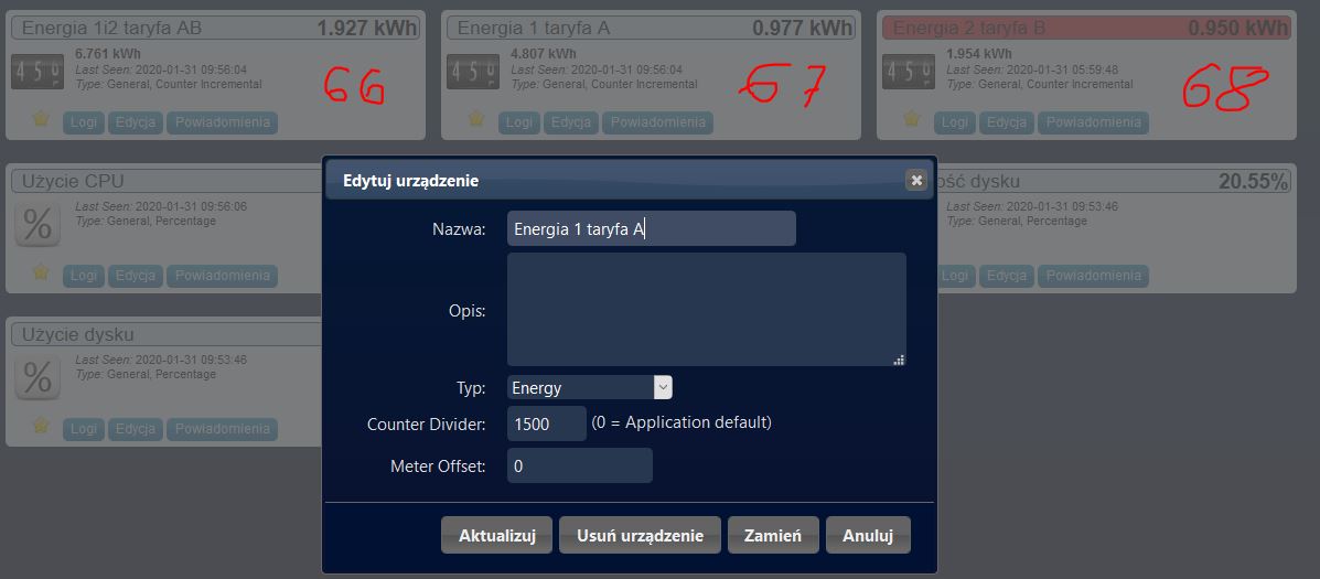

I have a dual tariff meter, so I created three counter types in domoticz.
1- suamrically IDX 66
2 - first tariff IDX 67
3 - second tariff IDX 68

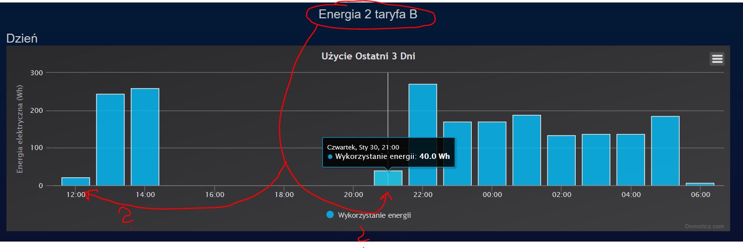

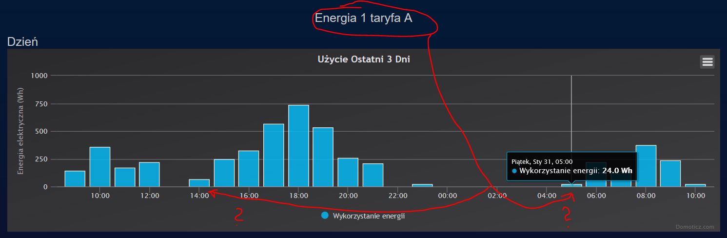

In general, it works only I do not understand the rules of saving data in domoticz. For example, if we have a transition between tariffs, when a tariff begins, devices in domoticz that theoretically should not count anymore, be able to count SOMETHING.
Tariff 1 IDC 67
Tariff 2 IDC 68
For example, after 6 am the 2nd tariff (IDX68) should not have entries in the database, meanwhile some entries in the domoticz test appear even until 6:55 and I do not know what is caused. Sometimes, as below, these are the same values ​​of 2931 - theoretically nothing, sometimes a few "Wh" will fall in the wrong hour.

OR IDX 67
sqlite> select * from meter where DeviceRowID = 67 and Date between "2020-01-30 12:00:00" and "2020-01-30 16:00:00";

-- counter should stop here
67|1339|0|2020-01-30 13:00:07

-- counter should start here adn its OK
67|1441|0|2020-01-30 15:05:00
