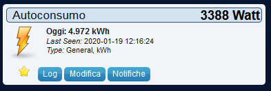

but it not works as expected: the devices: calorifero1p.state == "On" and calorifero_mans.state == "On" was ON and the dummy device "utility" power meter (instant enery+total energy) has a value > 2000 Watt
this one:
Screenshot_2020-01-19 Domoticz.png (8.31 KiB) Viewed 1571 times
but the script do not turn off:
calorifero1p.swichOff()
calorifero_mans.swichOff()
vcm_1p.swichOff()
vcm_mans.swichOff()
and also not turn on the other devices
PDC.switchOn().afterSec(10
PDC_automation.switchOn()
maybe the issue is how i try to compare the value inside dzvent about energy inside "if"?
if autoconsumo.value >= 2000

if i understand correctly the log, the error is at line 34
that's the line where i placed my info :
dz.log('AUTOCONSUMO = ' ..autoconsumo.value , dz.LOG_DEBUG)
i search inside wiki or google how i have to take the instant value (3388) Watt about this device:
Screenshot_2020-01-19 Domoticz.png (8.31 KiB) Viewed 1555 times
but i do not find, could be here the error?
Re: Manage switch selector and using different selection on "if"
megamarco83 wrote: Sunday 19 January 2020 14:49 i think that the problem could be how i menage to extract with dzvent the value about the enery utility devices:
value is not an attribute of a kWh device.
Available attributes for this type device are counterToday, usage, WhToday, WhTotal and WhActual

waaren wrote: Sunday 19 January 2020 23:22 value is not an attribute of a kWh device.
thanks, i use usage and now i get the value.
