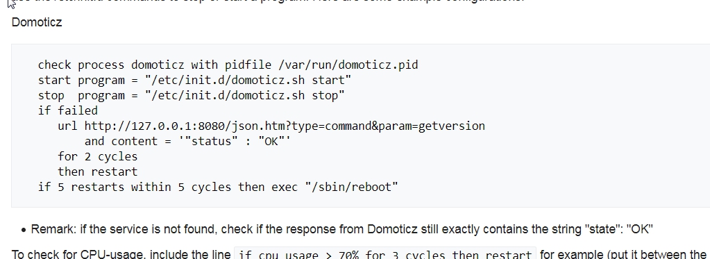

What are the correct settings for Monit.
I don't think the status check works for me.
Does anyone know how I check this.
https://www.domoticz.com/wiki/Monitoring_domoticz

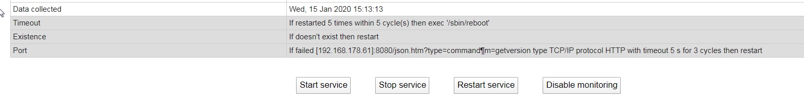

I use monit as well, and for sure I know it works.
I have the following contents in monitrc:
## Services
## Check general system resources such as load average, cpu and memory
## usage. Each test specifies a resource, conditions and the action to be
## performed should a test fail.
  check system <your IP address>
     if loadavg (1min) > 8 then alert
     if loadavg (5min) > 4 then alert
     if memory usage > 75% then alert
     if swap usage > 35% then alert
     if cpu usage (user) > 25% then alert
     if cpu usage (system) > 15% then alert
     if cpu usage (wait) > 15% then alert
## Check domoticz
  check process domoticz with pidfile /var/run/domoticz.pid
  start program = "/etc/init.d/domoticz.sh start"
  stop  program = "/etc/init.d/domoticz.sh stop"
  if failed
     url http://127.0.0.1:8080/json.htm?type=command&param=getversion
         and content = '"status" : "OK"'
     for 2 cycles
     then restart
  if 5 restarts within 5 cycles then exec "/sbin/reboot"
This works for one of my Raspberry Pi's , but for another I needed somewhat higher values.
How to check: Stop domoticz and monit will restart it.
