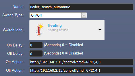

I have setup a Simple Thermostat using ESP8266, ESPEasy and some Domoticz.
The script is in python on my RPI and the ESP8266 Boiler switch is switched on with a switch in Domoticz. (see picture)
The problem I encounter is that ESP8266 drops it's WiFi connection every now and then.
It has happened one time after we came back on Schiphol and I wanted to fire up the heating @home and another time when the temperature rose to 22+ degrees, with relay switched on.
Not often but 2 times too much.
On both occasions ESP8266 had dropped it's WiFi connection.
The hard reset is the only way out in such a case.
