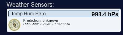

I use Davis meteo station and get data from baro device. Domoticz shor baro at hPa. I check setting and dont see where i can change unit to mmHg.
baro sensor from Davis.JPG (9.08 KiB) Viewed 1480 times

poleg wrote: Tuesday 07 January 2020 15:08 I use Davis meteo station and get data from baro device. Domoticz shor baro at hPa. I check setting and dont see where i can change unit to mmHg.baro sensor from Davis.JPG
You can't. It is not even allowed by law in the Netherlands. :D
