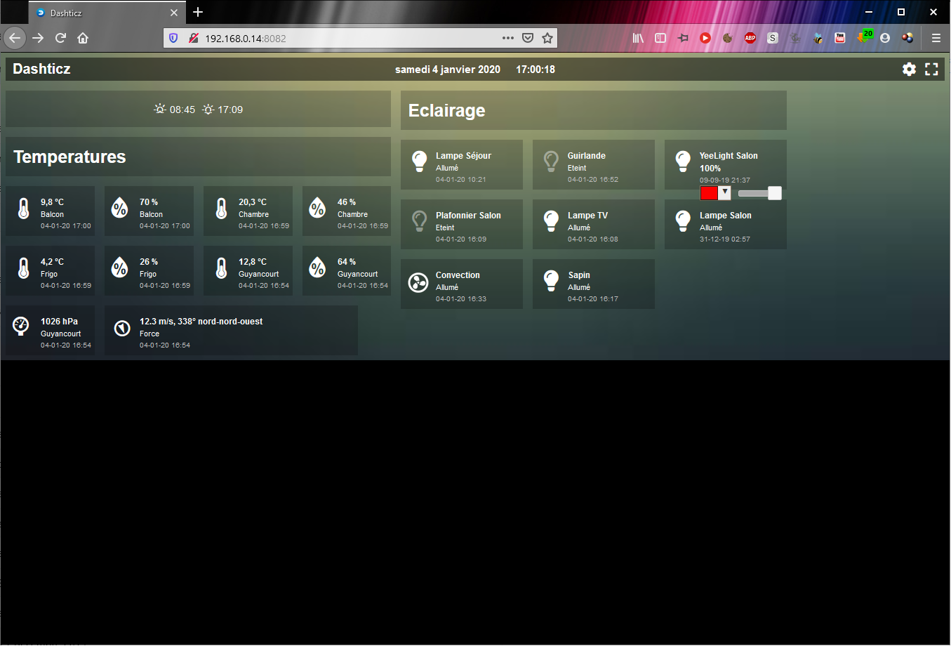

hello everyone,
I Installed the last beta automatically by following the wiki tuto.
Everything is working fine except the background is not using all the space of the screen: it doesn't scale in height, only in width. And this with any device.
Is this a bug or something I badly configured?
My config is rather simple... with "screen[1]" only used.

This is indeed a bug. I made some changes related to disable/enable horizontal swiping and vertical scrollbar, which introduced this,Kowet wrote: Saturday 04 January 2020 17:02 hello everyone,

If I remember correctly the background image doesn't fill the complete screen if you have defined only one dashticz screen. So as workaround you could defined a second screen.
I'll add it to the issue list on Github.

Fixed in latest beta.Lokonli wrote: Sunday 05 January 2020 11:05This is indeed a bug. I made some changes related to disable/enable horizontal swiping and vertical scrollbar, which introduced this,Kowet wrote: Saturday 04 January 2020 17:02 hello everyone,
