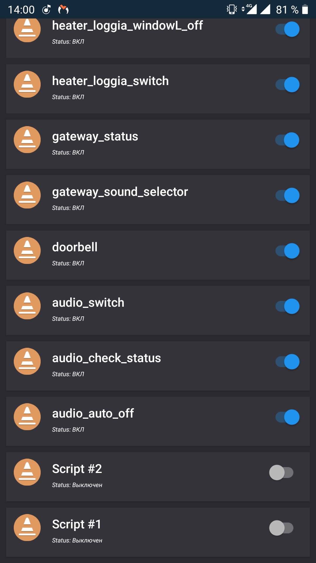

Hi all!
I want to use dzvents to switch triggers of other events.
Is it possible? Tnx.
