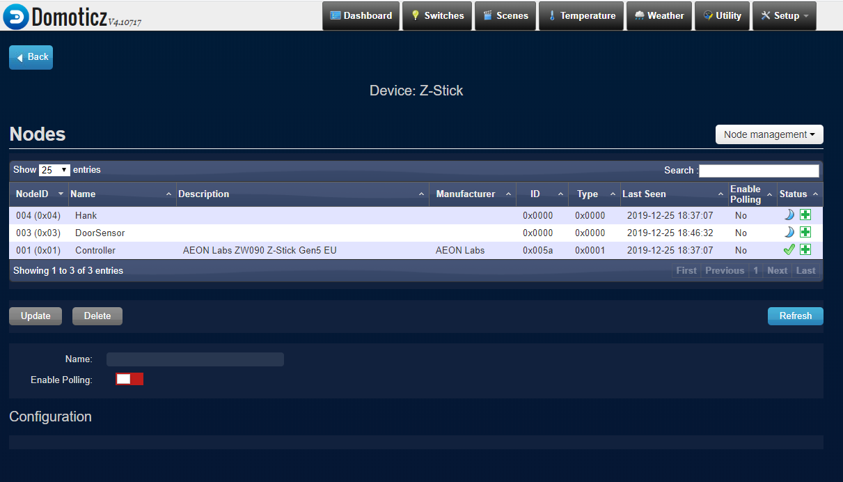

I have a problem with Zwave. It doesn't show any devices.
The system have worked, over Christmas I decided to move it to run from a USB stick. And when re-installing zwave it is partly dead.
It is a RPI2 with Domoticz V4.10717.
The Zwave controller is an Aeotec Z-Stick Gen5
I have a recessed door sensor gen 5 from Aeotec as well.
And a Hank four-key scene controller and som more.
The stick shows up.
I can configure it and open the Control Panel under Node management.
When triggering the door sensor I get this in Control Panel:
2019-12-25 18:46:32.808 Info, Node003, Received Basic set from node 3: level=0. Sending event notification.
2019-12-25 18:46:32.809 Detail, Node003, Notification: NodeEvent
See the attached picture.
The Last time scan time is updated for both the door sensor and the Hank controller.
So far all looks fine. But then they should show up at devices as well.
They do not.
In the Log I can see that Zwave was started at boot time. But after that nothing regarding z-wave.
Anyone that can tell me what is wrong?

- zwave.png (61.62 KiB) Viewed 415 times

Did you enable 'new devices'?

if batterypowered nodes:
include them again
include them again

Yes, enabled "New devices".
And batteries are fine. After including them again I got as far as explained above.
Zwave seem to work, but Domoticz fail to "see" Zwave altogether.

Is the location of your stick still the same in the OS after you started to use USB as your boot and OS drive? Please check it in the domoticz hardware section.U222 wrote:Thanks
