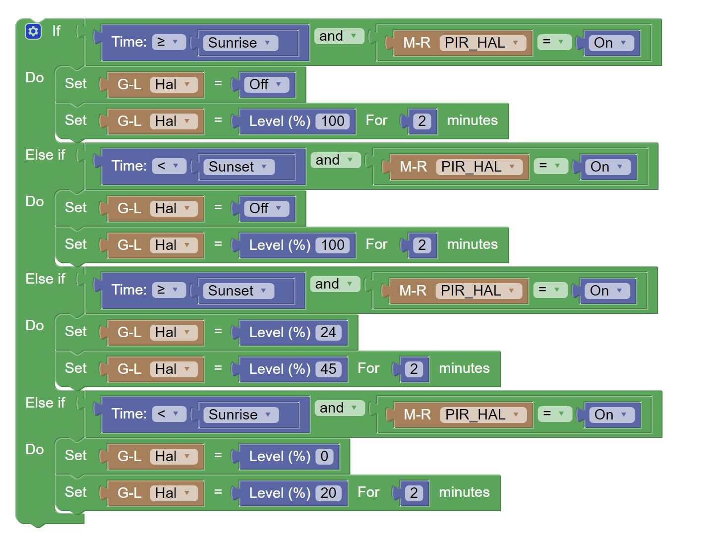

Im trying to automate my hallway lights (with motion sensor).. but depending on the time of day it has to act different.
As from attached blockly.. it random turns on and of.. i dont have any clues left.. Hopefully someone can help me out or put me in the right directions?

In your blocky you are triggering multiple things at the same time:
If "after sunrise" and "PIR_HAL is on" do:
- Hal off
- Hal 100% for 2 minutes
And you ask for "before sunset" the same 2 actions, but "after sunrise" and "before sunset" can be the same time.
So Domoticz doesn't know what to do. You should choose 1 of these conditions like:
If "after sunrise" and "before sunset" and "PIR_HAL is on" do:
Else if "After sunset" and "before sunrise" and "PIR HAL is on" do:
Hal 45% for 2 minutes
Or tell a little bit more about what you idea is. Hope it helps since I'm only a starter with a lot of questions also

Nice! thanks for reply, will try your suggestions! let you know if it works..
Re: turning on hallway lights depending on time of day
whoop whoop! thanks! working like a charm! first it didnt go back to the previous state.. (set from timer) bu now it does! Thanks Wouter!
