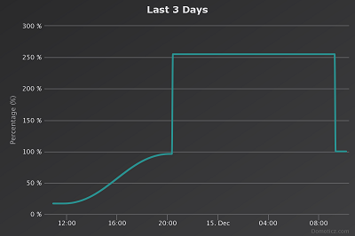

I use the following script to monitor the srt323 thermostat battery level:
Script1:
      timer = {'every minute'}
    execute = function(domoticz, dummy)
        local thermostat = domoticz.devices('SRT323')
        print('pile=' .. thermostat.batteryLevel)
        domoticz.devices('Pile Thermostat').updatePercentage(thermostat.batteryLevel)
This give the following graph:
Today: my battery level is 53% with domoticz.devices('SRT323').batteryLevel
With the API JSON:
http://192.168.0.4:8080/json.htm?type=devices&rid=96
I have the following line:
BatteryLevel 17
Confirmed with the Email notification:
Battery Low: SRT323 (Level: 17 %)
Is my coding of the above script wrong or is this a dzvent bug?

Re: SRT323: battery level is different with dzvents and API JSON
benp wrote: Saturday 14 December 2019 10:40 Today: my battery level is 53% with domoticz.devices('SRT323').batteryLevel
With the API JSON:
BatteryLevel 17
Is my coding of the above script wrong or is this a dzVents bug?
Both scripts seem to be ok. Domoticz does send the same data to dzVents as what is shows when called by the API.
If I compare the dzVents batteryLevel from all my battery enabled devices to what I get back from the API and to what I see on the GUI, the max delta = 1%
What do you see in the log from the print statement ?
Post by benp »
print=17% and 17% in setup/devices.
Since my last post, I did the following:
1- I start script 1 and script 2, script 1 failed to 17%
2 -I replaced my batteries and stopped script 2.
API JSON and setup/devices gives 96%
script 1 (domoticz.devices('SRT323').batteryLevel) still gives 17%
3-I start script 1 and script 2: still the same:
script 2, API JSON and setup/devices gives 96%
4-I reboot the raspberry: right values with script 1
script 1 (domoticz.devices('SRT323').batteryLevel) still gives 96%
With the API JSON: BatteryLevel 17
I rembered that I met this before.... I wrote a workaround script a couple of months ago.
I short: The batteryLevel of devices is send from domoticz to the event-system (including Lua, Blockly and dzVents) only when the Event-system is started.
benp wrote: Sunday 15 December 2019 10:58 I don't understand everything in your script. Is 255 means "not update value"?
255 means that the device has no value for battery level. Batterylevels are reported from 0-100
how can you do this(stop/start eventSystem)?
[Setup][Settings][Other]
disable EventSystem (Lua/Blockly/Scripts): and dzVents:
[Apply settings]
enable EventSystem (Lua/Blockly/Scripts): and dzVents:
[Apply settings]
