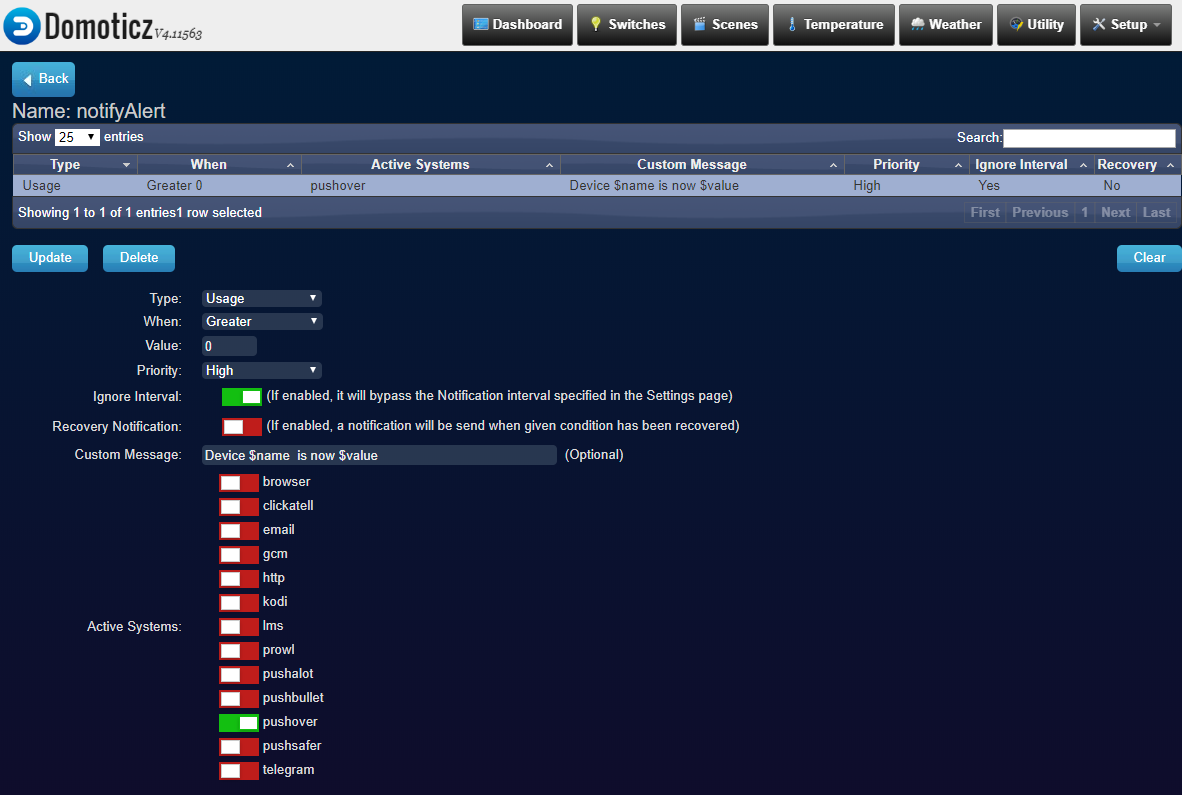

I'm trying to use notifications on an alert (dummy) to send myself a Pushover message.
This alert is activated via MQTT. I'm able to trigger the alert and the set Pushover action using the sensor but am struggling with the content of the message itself. I found that $value in the 'custom message' field returns me the state of the alert - 0/1/2/3/ etc. but not the text itself inside of my received Pushover message. What is the variable to use for this text?[url=https://reversephonelookup.onl/]reverse phone lookup[/url]nba reddit pcpartpicker
Thanks in advance.

Ressler wrote: Tuesday 10 December 2019 14:31 I'm trying to use notifications on an alert (dummy) to send myself a Pushover message.
I don't think there is another variable then $value and $name. If you want more flexibility you could consider scripting. In dzVents you can control the complete message. (see dzVents wiki for howto )
When not yet familiar with dzVents please start with reading Get started Before implementing (~ 5 minutes). Special attention please for "In Domoticz go to Setup > Settings > Other and in the section EventSystem make sure the checkbox 'dzVents disabled' is not checked. Also make sure that in the Security section in the settings you allow 127.0.0.1 to not need a password. dzVents uses that port to send certain commands to Domoticz. Finally make sure you have set your current location in Setup > Settings > System > Location, otherwise there is no way to determine nighttime/daytime state."
return
    on =
        devices = { 'notifyAlert'}, -- Name of your alert device
    execute = function(dz, item)
        local priority = dz.PRIORITY_MODERATE
        if item.color == dz.ALERTLEVEL_RED then
            priority = dz.PRIORITY_HIGH
            dz.notify (
                        subject,
                        message,
                        priority,
                        sound,
                        extra,
                        subsystem
        dz.notify   (   'My alert',
                        'Alertdevice ' .. item.name .. ' is now at level ' .. item.color .. '. Text is ' .. item.text,
                       priority,
                       nil,
                       nil,
                       { dz.NSS_TELEGRAM, dz.NSS_PUSHOVER }
