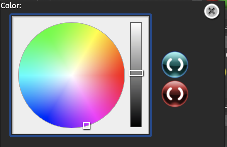

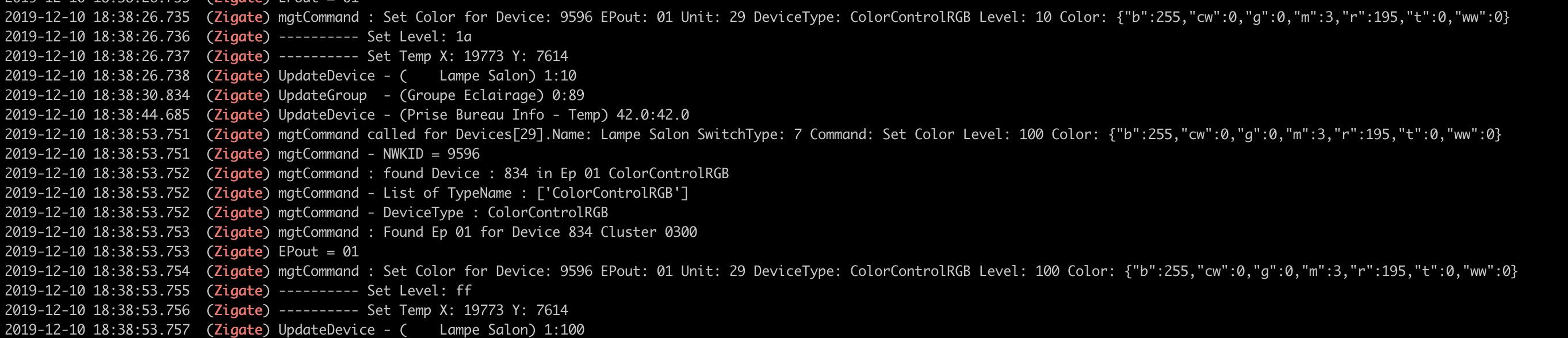

Just did a quick test on a simple RGB Bulb and brightness stay at 255,
Screenshot 2019-12-10 at 18.39.14.png (291.14 KiB) Viewed 1447 times
while Level is adapted based on the current level set with the RGB Color
Screenshot 2019-12-10 at 18.40.07.png (150.43 KiB) Viewed 1447 times

Hi Pipiche,
First scenario a white color is working fine.
2nd, setting a color. Color goes on but white doesn’t go off.
3rd, on a rgbwwz device on the combined mode you have two sliders for brightness. You have the main level and white level. The second log is when lowering the mail level slider. This works fine. But the white brightness slider does nothing. I guess level is the main slider and brightness is the white brightness, but I’m not sure.
Indeed it could be a Domoticz bug or a Gledopto bug.

ronaldbro wrote: Tuesday 10 December 2019 19:14 Hi Pipiche,
Good
ronaldbro wrote: Tuesday 10 December 2019 19:14 2nd, setting a color. Color goes on but white doesn’t go off.
This means that when Zigate send the command which is "Move To Colour temperature" the device do not do anything for the WW.
--> Could you try to do the following:
--------> Switch off the device
--------> Specify a Color with the RGB circle.
In other term, If I send a switch off, then setup RGB does it works ?
it is not switching off the WW
ronaldbro wrote: Tuesday 10 December 2019 19:14 3rd, on a rgbwwz device on the combined mode you have two sliders for brightness. You have the main level and white level. The second log is when lowering the mail level slider. This works fine. But the white brightness slider does nothing. I guess level is the main slider and brightness is the white brightness, but I’m not sure.
It looks like at the plugin level we do not receive the brightness information . I have posted here : https://www.domoticz.com/forum/viewtopi ... 65&t=30491 hope someone can react
