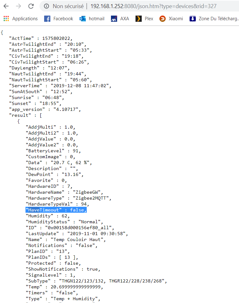

I have a problem with my xiaomi temperature sensors, which I link to domoticz via zigbee2mqtt.
It appears that the plugin does not manage the "expiry time" of domoticz's traditional devices.

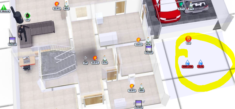

On the capture2 we see an example of a device that goes into error ...
I would like have this for my xiaomi temperature sensors.
If I well understand, the value "havetimout" determines this alert. if value is true, the alert appears .... here the value is false.
My question is therefore:
is it possible to replace this value in any way? api? lua? python? dzvent? shell?
I tried with dzvent a little script but nothing changes (caputre4) :s
Thank you for your help ^^
Antonino
Re: Dead devices -red banner by setting havetimout ?
antoninocanta wrote: Monday 09 December 2019 14:10 is it possible to replace this "havetimout" value in any way? api? lua? python? dzvent? shell?
I can only tell for sure that it is not possible using Lua / dzVents commands.
