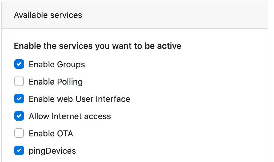

Do you have Group enable ?
Screenshot 2019-12-07 at 21.26.36.png (63.14 KiB) Viewed 2343 times

pipiche wrote: Saturday 07 December 2019 21:29 Do you have Group enable ?Screenshot 2019-12-07 at 21.26.36.png
Yes.

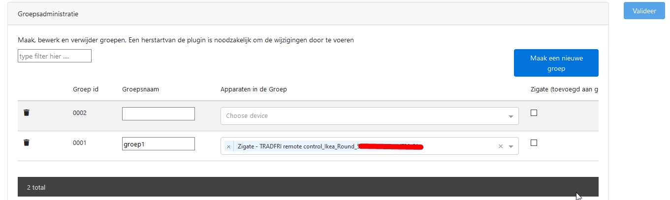

pipiche wrote: Wednesday 05 February 2020 17:38 Then with the Web Admin interface, you will edit the group and add Zigate to that group
When i add zigate to the group, i can't confirm that. After refresh of the group page the check mark is gone.
Any idea?
Mark

This is wat i see the group? Is this what you mean?
Adding zigate to the group doesn't work. I can't confirm it.
0 : Object {"GroupName":"","_GroupId":"0002","Devices":[]}
1 : Object {"GroupName":"groep1","_GroupId":"0001","Devices":[{"Ep":"01","_NwkId":"3802"}]}
pipiche
Posts: 2035
Re: zigate Ikea Tradfri remote
Post by pipiche »
You have to add ZIgate to the group as well
