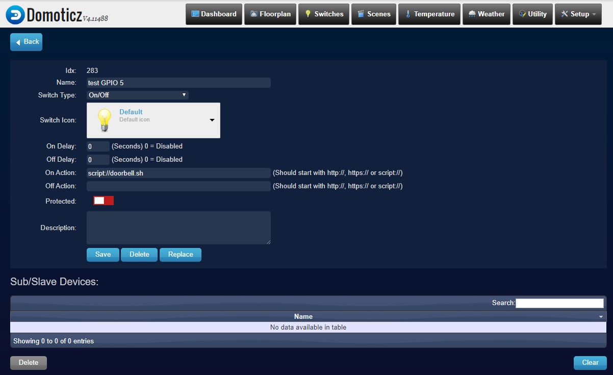

I have a switch in Domoticz that I can manually turn on and off.(Pic attached)
and refers to the Bash script
When I toggle the switch nothing, no sound nothing.

Re: Bash Script Problem on a Pi Running Domoticz 4.11488
waaren wrote: Saturday 30 November 2019 0:37
alarm_guy1 wrote: Friday 29 November 2019 20:57 I have no idea where to go with this as it appears to be working in Domoticz but no sound and def. works from the command line
Can you try with the full qualified scriptname ? So something like script:///home/pi/domoticz/scripts/doorbell.sh

Thanks for the quick reply,
Unfortunately that made no difference, other than stating it was working ok and executing the script.
It is like Domoticz doesn't have rights to the sound card or similar
