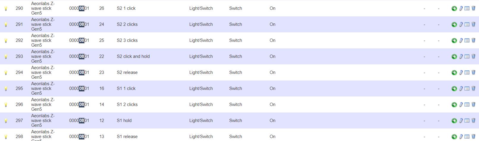

Gravityz
- Posts: 755
- Joined: Wednesday 16 December 2015 19:13
- Domoticz version: 2026.3
Re: Fibaro FGD212 S2 button as activator / deactivator
strange.
i assume you are running the latest domoticz version which uses the zw1.6 implementation?
you should have devices like the screenshot i showed.
i renamed them so that i can recognize what is what.
is S2 set correctly in the dimmer (as a push button or a toggle switch)
scene activation was activated.
if you never cleared out you zwave cache file that might be the problem.
the FGD212 devices might need to be recreated in the cache file.
let me know wat your setup is and how long it has been this way.
if all things are in place it should work like i said
1 click, device is made (rename to S2 1 click)
2 clicks, device is made (rename to S2 2 clicks)
3 clicks, device is made(rename to S2 3 clicks)
if this is not working now i suspect the device was added a long time ago and needs to be re added in the cache file
if this is the case i can tell you how to do things

Gravityz
- Posts: 755
v4.10717 is a really old version which works with openzwave 1.4
that being said that version is very stable and should work with scene activation
the last version i used with open zwave v1.4 was 4.10734
there was a version which had a bug in it which caused the scene activation not to work but i do not know if this was the one.
i looked at my copies and v717 and 734 are 2 days behind so it could be that you need to upgrade to v4.10734
what system do you have, how do you install domoticz?
going to a newer version with openzwave v 1.6 might y cause more problems because it took a lot of time to get v1.6 stable and working again.
ask on the forum if it is save to go from your version to the latest version and how you should do this
current version is V4.11762 and i believe upgrading from 1.4 to 1.6 without you knowing how things work is a serious risk
then again you are just starting out so maybee the risk is not that big
look at my device list.
all those 801 devices you see should be there in your setup as well
they are created the moment they are activated
in my setup
801 1 is the S1 switch which controls the dimmer
801 1 is a kWh meter
when you goto the setup of the FGD212(setup-hardware-zwave setup)
what do you see in all the registers

here is my setup
in my setup

legan
- Posts: 9
- Joined: Friday 29 November 2019 10:02
I used this method, as mentioned in the installation wiki: curl -L https://install.domoticz.com | bash
It was a couple of weeks ago and it gave me that version. Installed on a Raspberry Pi 2.
The setup for options 20 to 29 is:
It might be worth mentioning that I have walked through our house with the Aeotec stick to associate the devices and experimented on Windows a bit before connecting the stick to the Raspberry Pi. Could that have done something wrong with the ZWave configuration?
So I modified the option 23 to 'disabled'.20. Inputs Button/Switch configuration:

no i do not think so.
somehow the FGD212 is not generating new devices when you click the buttons.
maybee it is a good idea to install winscp on your pc and try to make a connection with the pi.
if you are able to browse through the files i can tell you how to delete the cache file.(make a copy to be save)
This resets the devices and domoticz will add then automatically to the system.
when you first installed domoticz and had the ACCEPT NEW HARDWARE DEVICES set to on it discovers each device and puts them in a file called zwcfg_0xxxxxxx.xml
this file is in the domoticz/var directory.
when you delete this file, stop domoticz and start it up again in collects all the devices again.
i think something went wrong in there.
yes.
just one check to know for sure the FGD212 is set correctly
go to setup hardware-zwave setup
select the fgd212
press the request current values from device
press ok
select the fgd212
press ok
select the fgd212
go to register 28
is the scene functionality enabled?
sometimes what you see on the screen in not what is actual in the device(hence the request values twice)
make a backup from the zw file(rename it with the .org extention) just in case
delete the original file (keep the backup)
make sure the ACCEPT NEW HARDWARE DEVICES option is set to ON in the domoticz settings
stop domoticz
start domoticz
if you look in the log after starting up domoticz you see that it discovers all the devices again.
if you have devices with batteries this will take longer(or you need to press the wake up button)
if this does not solve he problem then my only guess is the 717 verion is the one in which the scenes are deactivated
in case things go wrong
stop domoticz
restore the old cache file
start domoticz

legan
- Posts: 9
Thanks a lot for helping me out here!
I just did that procedure to get the stored values from the device and option 28 remains on 'functionality enabled'.
So, remove the config file, restart domoticz and indeed all devices are discovered again.
Then, the magic moment and the button is now recognized as a scene activator!
Very grateful!
Very grateful!
glad i could help You out.
You can now also create the other scenes (double click, triple click, clikc and hold)
click and hold is my favorite, i use it to turn of all my lights.
sometimes when there are a lot of changes regarding zwave functionality(changes in device configs) it is always good to do this procedure.
i think your stable version still works with zwave v1.4
newer builds(anything newer then v4.10734) use zw1.6
this change initially caused a lot of problems with devicefiles needed to be changed.
We have had al that and also that version is running very stable.
fyi, the cache file in those versions is called ozwcachexxxx
same procedure applies whenever you need to refresh domoticz
