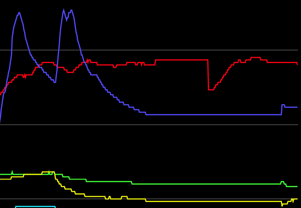

Yes, I have some flat lines in the graphs...

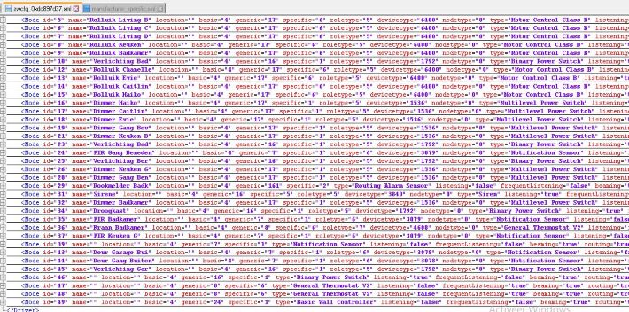

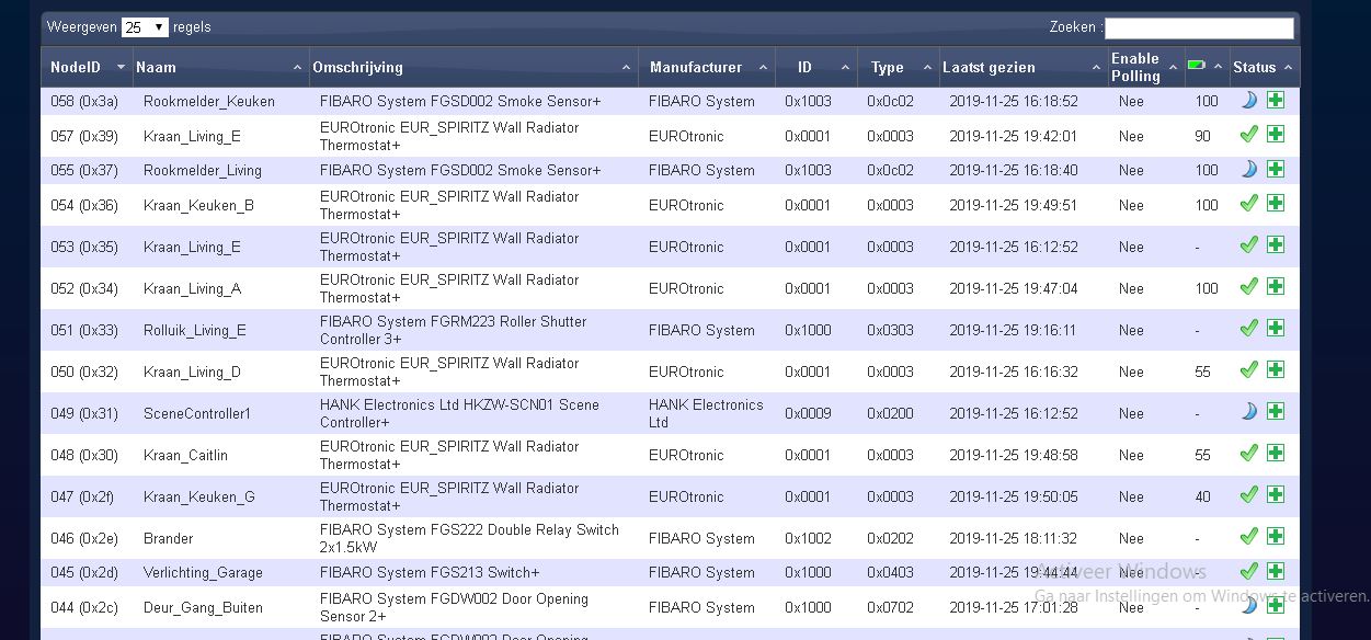

hmm, just noticed something strange:
when i open the xml file: zwcfg_0xdd897d37.xml
there is see the last node is number 49
When i check in my zwave panel in Domoticz, my last node is 58
And the 2 new smoke sensors i added are node 55 and node 58
So maybe there is something wrong with my xml file?
I can just delete the content inside it?
And everything will be loaded again in it without i need to reconfigure everything?
Thank you

- Egregius
- Posts: 2592
- Domoticz version: v2024.7
- Location: Beitem, BE
Re: Fibaro Smoke Sensor2 (FGDS-002) not reporting temperature
Isn’t there another ozw cache file with your home id in the name?
ropske
- Posts: 483
- Joined: Tuesday 12 August 2014 5:37
- Domoticz version: V3_8394
- Location: Rumbeke,Belgium
Idd there is: ozwcache_0xdd897d37.xml
ropske
- Posts: 483
here all nodes are included
