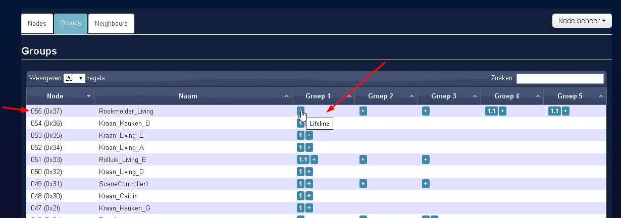

i bought some of these Smoke Sensors from Fibaro, but the temperature is not updated,
what i can see in the groups, is that the LifeLine is not 'connected' to the main controller.
if i want to link it to the main controller, the number1 (main controller) just doesn't shows up.
Anyone else has this problem or knows how to solve?
Thank you.

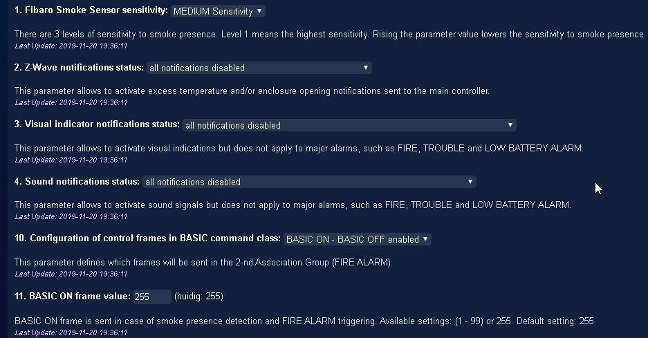

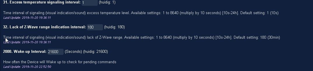

Normally, i don't need to link it i think?
When i wake up my device by manually pressing 3x the b-button, it is sending the new temperature.
But it is not sending it automatically, and according to the parameters, it should send everytime when there is a change of 0.3 degrees.
And when there is no change, it must send every 10minutes (thats what i configured in the parameters)
