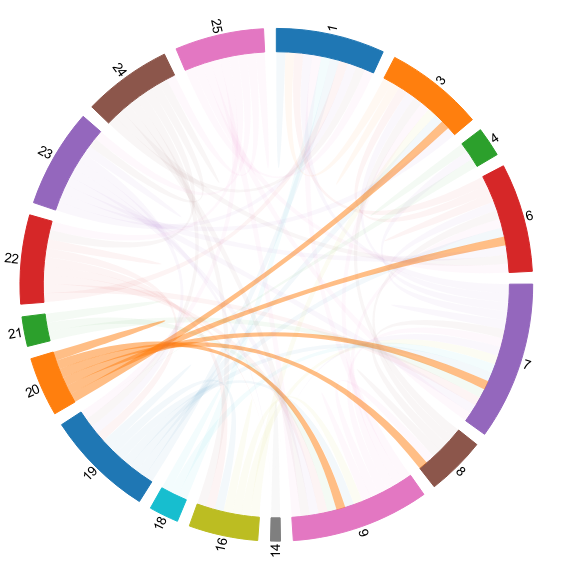

Here is my network topology with node 20. It seems well connected, but not directly to the controller. Which is weird, since the controller and heater node 20 are in the same room (kitchen). Whereas other nodes located on upper floor and at the other side of home work better.
Screenshot from 2019-11-19 18-03-12.png (142.34 KiB) Viewed 2699 times
For the 3s timeout, this reminds me this comment (in this case timeout was suspected but not the issue because command was immediately discarded):
https://www.domoticz.com/forum/viewtopi ... 43#p227843
So this is expected behavior.
Strange to have the device not able to reach controller directly, but this may happen (fading). In the past, devices that were not included on their location but close to controller (before remote inclusion feature) also had issues, but this time this was a direct route that may be no more available after inclusion close to controller, so the opposite...
Anyway having hops may add latency even if 3s looks large. I sometimes also experience timeouts in my setup, but this still works: Timeout reached will trigger a retry...
I also observe that the previous messages were not timeouts but maybe more related to z-wave command stack: Still think this stack was not able to deliver commands at all because too many messages at the same time.
So 1st check if this does the job, if not, maybe a message on OZW github to get more advice from there: Some configuration knobs may help, or tips to have network heal really updating current mesh.
