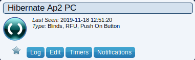

When I first created these I used an On/Off switch until I realised that there is a Push-On Button option in Domoticz which does not display On or Off on the dashboard. Unfortunately when I create a block in Dashticz to show this button, Dashticz shows the status as On or Off. (I've tried creating switches with sliders and dimmers and they seem to be OK in Dashticz.)
Domoticz push-switch.png (13.34 KiB) Viewed 1124 times
