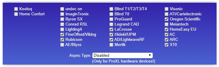

I have a TFA Dostmann temp sensor 30.3221.02 that is not connecting to my Rasp-Pi 3b+ and RFXtrx433X.
New batteries, tried all channels, tried pushing the white button 3 and also 10 sec.
Screen Shot 11-06-19 at 01.54 PM.JPG (110.81 KiB) Viewed 1502 times
Okay, It did connect once, gave 15 min same temperature then it lost connection. tried all the same it did not come back.
Anyone a solution?

This sensor is not in the list of supported sensors, see chapter 2 in the RFXtrx User Guide.
