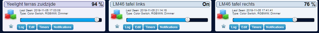

i noticed lately that the hue lights do not reflect the percentage when switched on manually
e.g. when switched by using a script the Set Color is used and the light is set to percentage(eg 80%)
but when you switch the light off and then on again the status is set to ON and not 80%
It should reflect the current setting, not the last command send to the light.
this bug is probably in there for a while but i just noticed it when i was playing with openhab connectivity.
the zwave lights do not have this problem because they use set level instead of Set Color.

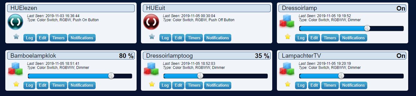

no it is like i said
with zwave dimmer it works as expected
turn dimmer on with a script to 70% result:70%
turn it off in the gui result:Off
turn it back on in the gui result:70%
if the light is on and the level is set to 70% it always displays rthe level, not on
with hue rgb light
turn it back on in the gui result:On
if it is a design thing it is not designed concequently thus this is a bug
with hue rgb light

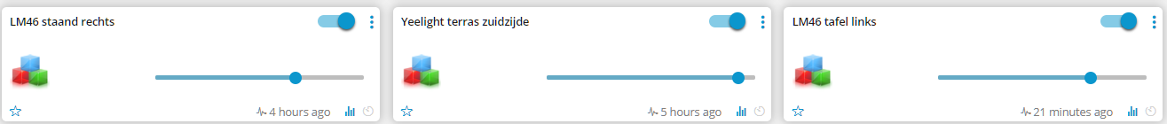

the problem is not that the lights do not show the correct brightness
the sliders in both the hue app and domoticz are in the corect position.
The only thing going wrong is that when the light is switched on by using the on button it does show ON and not the percentage.
Apparently the problem is so simple that nobody sees it.
when switched on from domoticz using the lightswitch when switched on from domoticz using a script when switched on from the hue app
when a switch is pressed from domoticz a zwave dimmer get the Set Level command:result percentage shown
when a switch is pressed from domoticz a hue color light gets the ON command:result status ON, NOT GOOD
when a switch is pressed from homekit/hue app a hue color light gets the Set Color command:result status percentage
so either we make sure the correct ON command is used for the buttons in domoticz with hue lights (Set Color)
or we make sure the status is always derived from the actual brightness setting of the hue light.
please inspect the code difference between a zwave dimmer and a hue color light.
these things need to work equally
i would opt for option2 make sure the status is always derived from the actual brightness setting of the hue light
this way it always works regardless of what current/furure commands are used

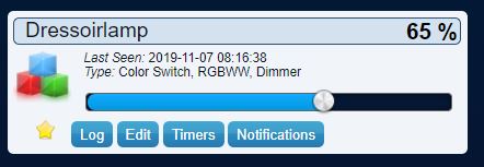

i noticed something strange.
when i stop domoticz and then start domoticz again the light status of the lights is in percentages(if they are on)
now if i go to a hue light and switch it off and then back on it shows the percentage like i think it should.
problem is it only does it 1 time.
second off/on results in the ON status of the light.
i checked and it only works 1 time and only with 1 light (so not 1 time per light)
weird
maybee you can look into this.
weird

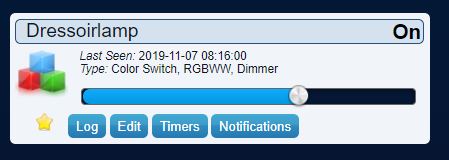

Re: hue lights do not reflect percentage when switched on
i bypassed the bug by updating the hue status using a dzVents script
every ON command fired at the HUE light will result in an updated light status with the correct percentage displayed.(like it should have been coded from the start)
problem solved
problem solved
