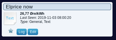

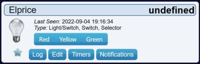

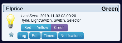

create one text dummy device, and one dummy switch selector, as shown in pictures below. Note that the most expensive price in selector is Red and have value 0, which is the switch set to OFF, so it should be fairly easy to check if lamp is off then don't use electricity

Dummy switch selector show pricing as traffic light, to be used for enable/disable switches for heating

            domoticz.devices('Elprice now').updateText((myCurrentpriceDKK .. " Øre/kWh"))
            --Set traffic light colour
            if tonumber(myCurrentpriceEUR) >= redCostEUR_kWh then
                domoticz.devices('Elprice').switchSelector(0)
                --domoticz.log("Red")
            --if tonumber(myCurrentpriceEUR) < yellowCostEUR_kWh then
            if ((tonumber(myCurrentpriceEUR) < redCostEUR_kWh) and (tonumber(myCurrentpriceEUR) > greenCostEUR_kWh)) then
                --domoticz.devices('Elprice').switchSelector("Yellow")
                domoticz.devices('Elprice').switchSelector(10)
                --domoticz.log("yellow")
            if tonumber(myCurrentpriceEUR) <= greenCostEUR_kWh then
                domoticz.devices('Elprice').switchSelector(20)

Somehow I can't attach 4 pictures so here are the switches as they appear in Domoticz

            --comment below to reomve price in øre/kWh
            local myCurrentpriceDKK = (convert)
            -- update text device with current electricity price
                --domoticz.log("Green")
