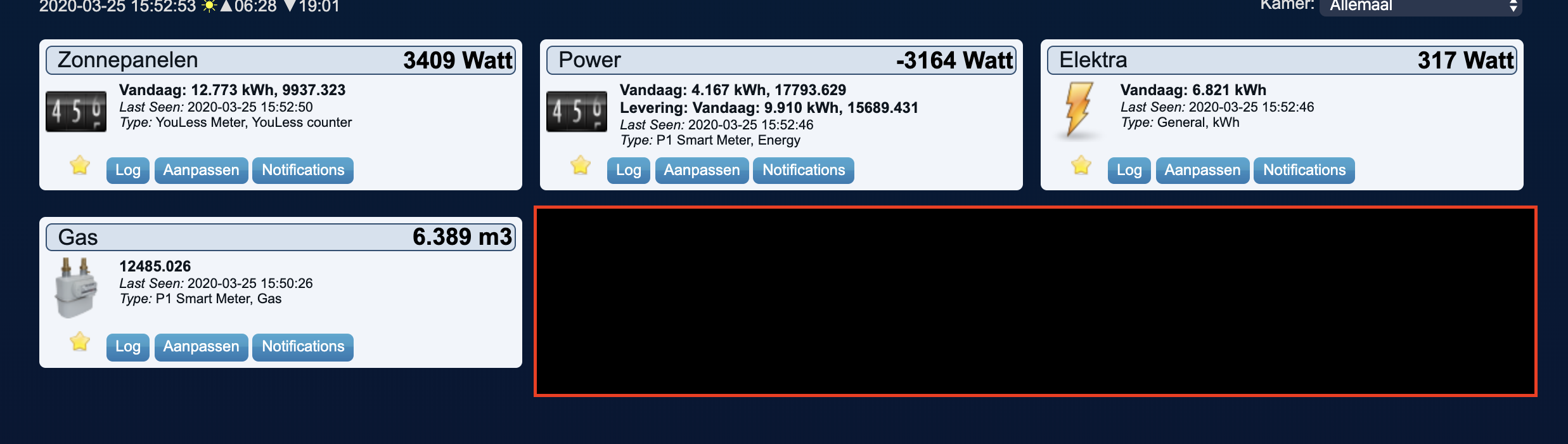

Great!
Could you please help me out. I have these devices as seen on the picture now which were fine for uploading to pvoutput.
Zonnepanelen=solarpanels (youless)
Power=P1 (youless)
Elektra=calculation (zonnepanelen-power)
Gas=P1 (youless) Where do I have to enter them in the dzevent script?
I let temperature coming in pvoutput from wunderground (filled by my meteobridge nanosd). No voltage.
Devices setup in domoticz
Schermafbeelding 2020-03-25 om 15.52.55.png (224.72 KiB) Viewed 3918 times
