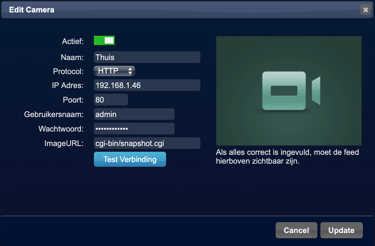

I have connected the Dahua camera with Domoticz.
Only a few seconds the camera gives me an image, after this the connection is lost!
What could be the cause of this problem and how to solve this?

Dahua camera DH-SD22404T-GN-S2 4MP PZT
- Schermafbeelding 2019-10-24 om 08.34.52.png (299.84 KiB) Viewed 914 times

Camera support is sometimes slightly buggy in my experience. Did you try to accept those settings anyway and test in Android app/web UI wether it is working. Just wait for some time and see if it loads.

Better not to rely on the "Test Verbinding" option. I have 2 Dahua camera's also and they are connected to Domoticz. For the imageURL I use : cgi-bin/snapshot.cgi?Channel=0
Maybe worth to give that a try. My other settings are similar to yours.
