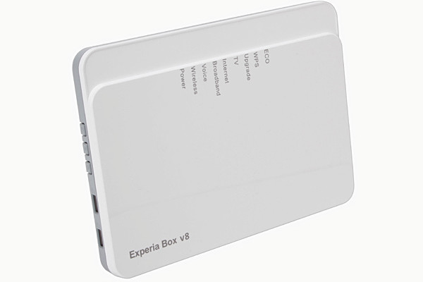

My internet service provider has supplied a KPN router of the type Experiabox V8 (Arcadyan VGV 7519) in order to connect to the internet.
This router has also the possibility to serve as a wireless access point. Because of the poor quality of that functionality I don't use it, as such.

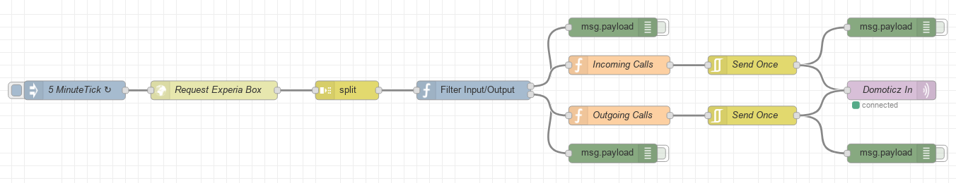

Node Red Experiabox_flow.png (41.85 KiB) Viewed 1182 times
1. The first node is a simple inject node, configured as a 5 minute pulse in order to poll the URL of the Experabox every 5 minutes.
Feel free to change it to any value you like.
2. The second node is a http request node to poll the Experiabox URL.
The "Method" is: GET and the URL is: http://192.168.2.254/voip_status.stm (Default KPN IP address).
Tick "Use authentication" (basic authentication), No Username and as Password the one you have configured in your Experiabox to access the
web page. This will result in a stream of data, to much for the debug pane. I routed it to a file.
3. The third node is a split node in order to get multiple messages, so that it can be filtered in:
4. The fourth node is a filter node, in order to split between Incoming an Outgoing calls and to get rid of unneeded messages.
5. The fifth node is a function node to prepare it for Domoticz.

6. The sixth node is a standard RBE node, in order to avoid that the message will be sent every 5 minutes and that it will fill the Domoticz log very quickly.
7. The last node is the MQTT Input node to Domoticz.
The complete flow has been published below:

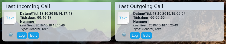

In order to use this flow for your application you have to create 2 virtual "Text sensors" for Incoming calls and Outgoing calls.
Do not forget to replace the IDX numbers for the IDX numbers of your newly created virtual sensors.
For privacy reasons the telephone numbers has been removed.
