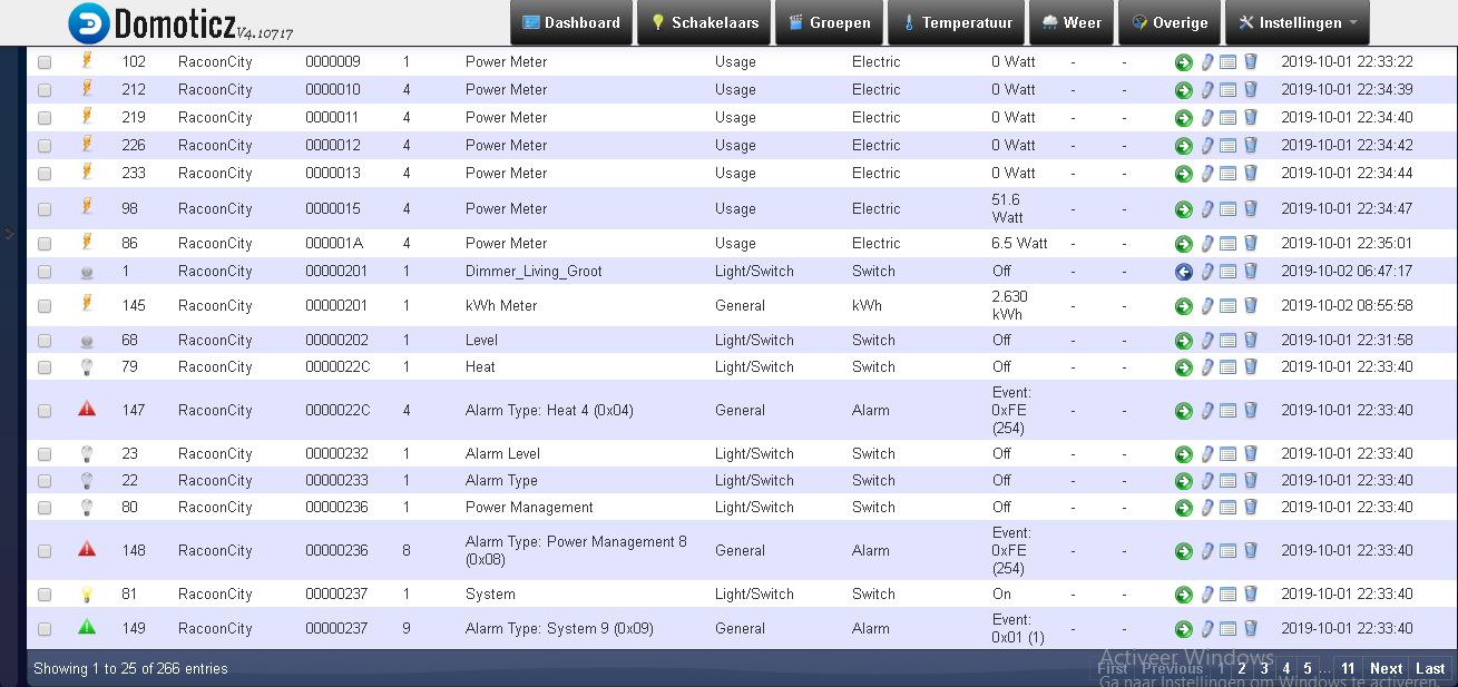

So how can we see the highlighted id?
Thank you

I should show up in the Devices list for the ZWAVE devices in the standard theme as shown in the thread I pointed you to.
I can't check whether that is still the case or not as I am not running any of the recent versions, but in your list it seems to be missing.
Jos

I'm running now V4.10717 and default theme, but it is not in anymore it seems

I haven't installed the 4.**** version as yet as my current setup is rocksolid. My test system is running 4.10262, but it seems changes were made after that version to the filestructure as the file /www/app/DevicesController.js doesn't exist anymore in the latest Beta.
A quick search found that in file www/app/Devices.js line 255 contains the part that was modified originally in the second patch:
				var ID = device.ID;
				if (typeof(device.HardwareTypeVal) != 'undefined' && device.HardwareTypeVal == 21) {
					if (device.ID.substr(-4, 2) == '00') {
						ID = device.ID.substr(1,device.ID.length-2) + '<span class="ui-state-default">' + device.ID.substr(-2, 2) + '</span>';
					} else {
						ID = device.ID.substr(1,device.ID.length-4) + '<span class="ui-state-default">' + device.ID.substr(-4, 2) + '</span>' + device.ID.substr(-2, 2);
So I have no idea why it doesn't highlight for you, but you could try to check in Chrome with the developer mode (F12) and check out the generated source for the page/device to see if it is there. Also check if the class "ui-state-default" is still valid and different from the rest of the formatting.
