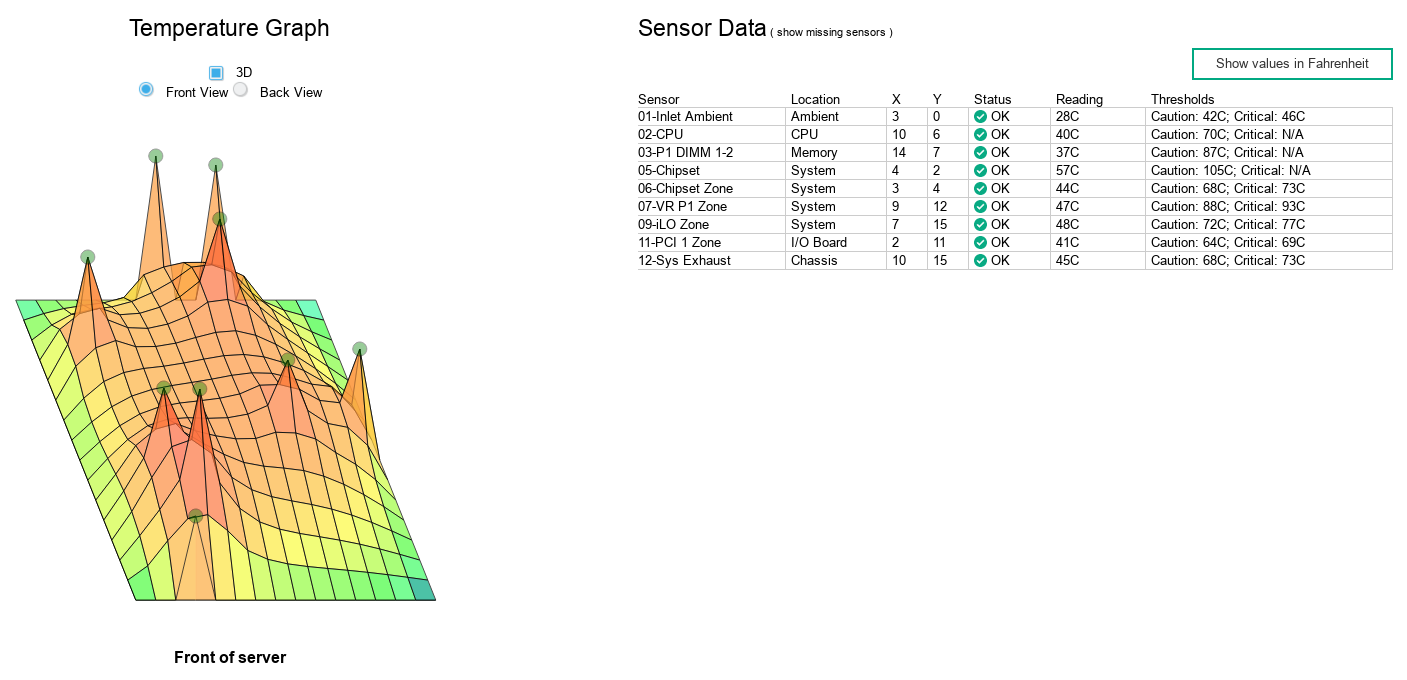

2. Next step was the download the ZIP file ilo_data.zip
This file needs some modifications, which depends on the temperatures, you want to monitor and how they are named.
See the example below:
In this case you will find the exact sensor names in the column, marked "Sensor". In totally 9 sensors.
This maybe different for other servers.
You need to modify the following to your personal settings:
1. ilo_ip (between ' ')
2. user, HP default Administrator (between ' ')
3. password, as on the attached label (between ' ')
4. the second field between [ ] should match the name of the temperature sensors. See picture above.
5. IP address of your Domoticz server and IDX for the created virtual sensors in the "requests.get(...." line.
The file has been installed in ~/domoticz/scripts/python directory.
If the script runs without errors, you can create a cronjob, in order to run the script periodically.
