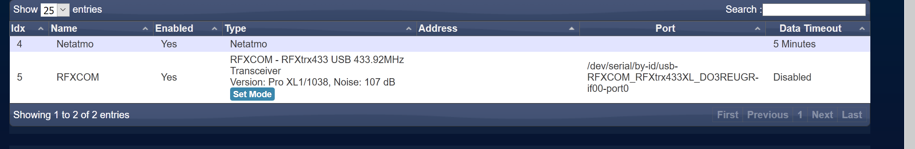

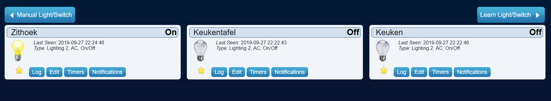

I configured the transciever to work with 'klikaanklikuit' switches. This is working fine when I boot up the raspberry pi. After approximatly 10 minutes, I cannot control the switches anymore with domoticz. It is yust not reacting anymore (the virtual switch in the software is switching, the physical switches not).Someone who recognize this problem?

- Note that the RF noise of 107 is much too high. For a good receive functioning you should have a figure between 85 and 95. Do not locate the RFXtrx and USB cable close to other equipment including the RPI.

Problem stays the same. Now 90dB noise, still after some minutes the switches do not turn on or off. When i disable the antenna in the hardware section en re-enable it, it doesn't show any number for the noise, so it seems that on that moment there is no connection between the raspberry pi and the antenna.

Tried different power supplies, nothing worked. Also, when the transciever works, I see lights flashing when I switch. When it's not working, domoticz still says 'switching', but the lights do not flash on the RFXCOM.
