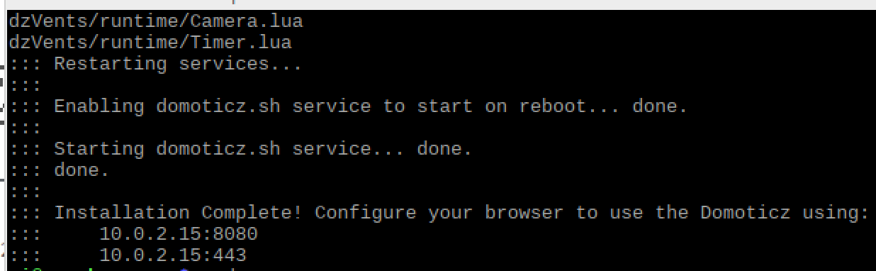

I _really_ appreciate the help!
Screen Shot 2019-09-20 at 7.58.46 AM.png (68.49 KiB) Viewed 509 times
Here's a screenshot of the install output. `ps -ef | grep [d]omo` doesn't return anything

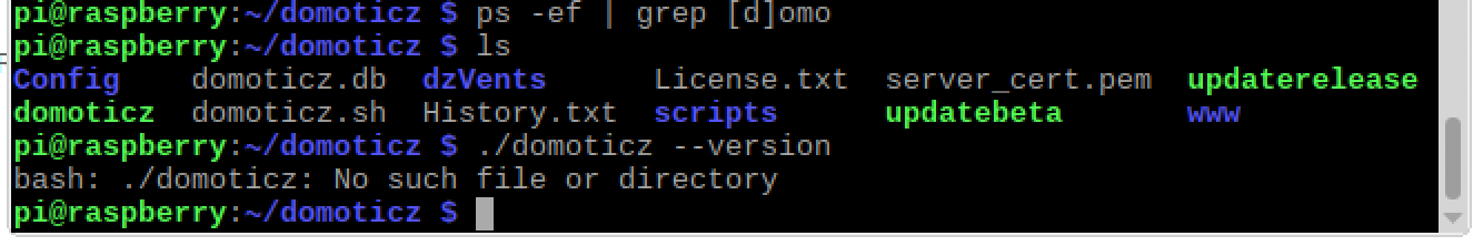

rasputin wrote: Friday 20 September 2019 15:30 ps -ef | grep [d]omo doesn't return anything
OK. On the command line do a cd to the directory where you installed domoticz and see what happens when you ask the version or start domoticz from the command line.
for example
cd /home/pi/domoticz
./domoticz --version
./domoticz

No such file or directory
Screen Shot 2019-09-20 at 9.44.40 AM.png (88.41 KiB) Viewed 503 times
At this point I think something failed in such a way that the system isn't seeing the domoticz build as an executable.
