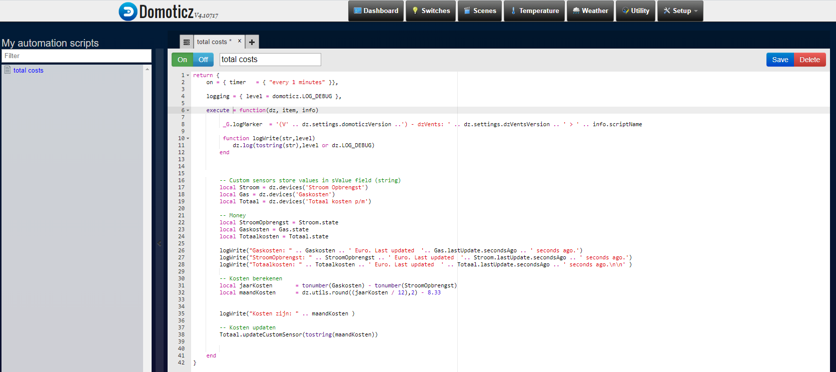

    on = { timer   = { "every 1 minutes" }},
    logging = { level = domoticz.LOG_DEBUG },
    execute = function(dz, item, info)
         _G.logMarker  = '(V' .. dz.settings.domoticzVersion ..') - dzVents: ' .. dz.settings.dzVentsVersion .. ' > ' .. info.scriptName
         function logWrite(str,level)
            dz.log(tostring(str),level or dz.LOG_DEBUG)
        -- Custom sensors store values in sValue field (string)
        local Stroom = dz.devices('Stroom Opbrengst')
        local Gas = dz.devices('Gaskosten')
        local Totaal = dz.devices('Totaal kosten p/m')
        -- Money
        local StroomOpbrengst = Stroom.state
        local Gaskosten = Gas.state
        local Totaalkosten = Totaal.state
        logWrite("Gaskosten: " .. Gaskosten .. ' Euro. Last updated  '.. Gas.lastUpdate.secondsAgo .. ' seconds ago.')
        logWrite("StroomOpbrengst: " .. StroomOpbrengst .. ' Euro. Last updated  '.. Stroom.lastUpdate.secondsAgo .. ' seconds ago.')
        logWrite("Totaalkosten: " .. Totaalkosten .. ' Euro. Last updated  ' .. Totaal.lastUpdate.secondsAgo .. ' seconds ago.\n\n' )
        -- Kosten berekenen
        local jaarKosten       = tonumber(Gaskosten) - tonumber(StroomOpbrengst)
        local maandKosten      = dz.utils.round((jaarKosten / 12),2) - 8.33
        logWrite("Kosten zijn: " .. maandKosten )
        -- Kosten updaten
        Totaal.updateCustomSensor(tostring(maandKosten))

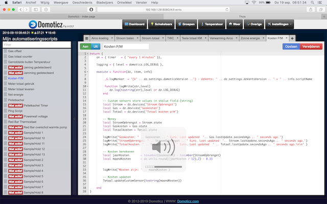

Knibor
Posts: 112
Joined: Sunday 20 May 2018 12:56
Domoticz version: Stable
Re: dzVents script for calculating Gas/electricity cost per month
Post by Knibor »
I used your dzVents script, the script gives me no error. In the log status there are no logs from "Gaskosten" "Totaal kosten p/m" and "Stroom Opbrengst" ?
It looks or the script is not running?
Knibor wrote: Wednesday 18 September 2019 23:53 Hi,
If you do not see anything in the log. The script does not run.
Is dzVents enabled in the settings ?
Knibor wrote: Thursday 19 September 2019 0:18 dzVents is enabled, the log file gives me this output, but not the log when I filtering on "total costs"
If you load the script in the event page and save it with the On button being green
you should see something like this with the marked lines.

Knibor
Posts: 112
Post by Knibor »
The button is Green when I upload the script.
But i don't see in the Log the marked Lines.
Schermafbeelding 2019-09-19 om 08.51.34.png (197.06 KiB) Viewed 1388 times
Knibor wrote: Thursday 19 September 2019 8:59 The button is Green when I upload the script.
The screen shot is a bit vague but I don't see anything strange here. It sure looks like no scripts are saved from your event editor.
My next steps would be:
clear browser cache and -appcache (different things) and try again to save the script.
If no result then on the CLI do
cd <domoticz dir>
ls -lR scripts/dzVents/generated_scripts
# output on my system:
scripts/dzVents/generated_scripts:
total 8
-rw-r--r-- 1 pi   pi    189 Aug 29  2017  README.md
-rw-r--r-- 1 root root 1545 Sep 19 11:13 'total costs.lua'
If the script is not in this generated_scripts sub directory then try again using another browser. If no result then
save the script manually to your system as
<domoticz dir>/scripts/dzVents/scripts/'total costs.lua' # or any other name as long as you use the extension lua
dzVents looks at both directory's and process the lua files in here in exactly the same way.
NB. quotes are only required if you use a space in your scriptname.
Knibor
Posts: 112
Post by Knibor »
Tried all the above suggestions, it didn't solve the problem.
I installed Rasp pi Domoticz stable new, and build up everything from the beginning.
Now it works again.
Knibor wrote: Friday 20 September 2019 10:40 I installed Rasp pi Domoticz stable new, and build up everything from the beginning. Now it works again.
👍 Good to read that it's working again. Hopefully it was just a one time incident and does not hit you again. Would be good to understand the root cause of this.
