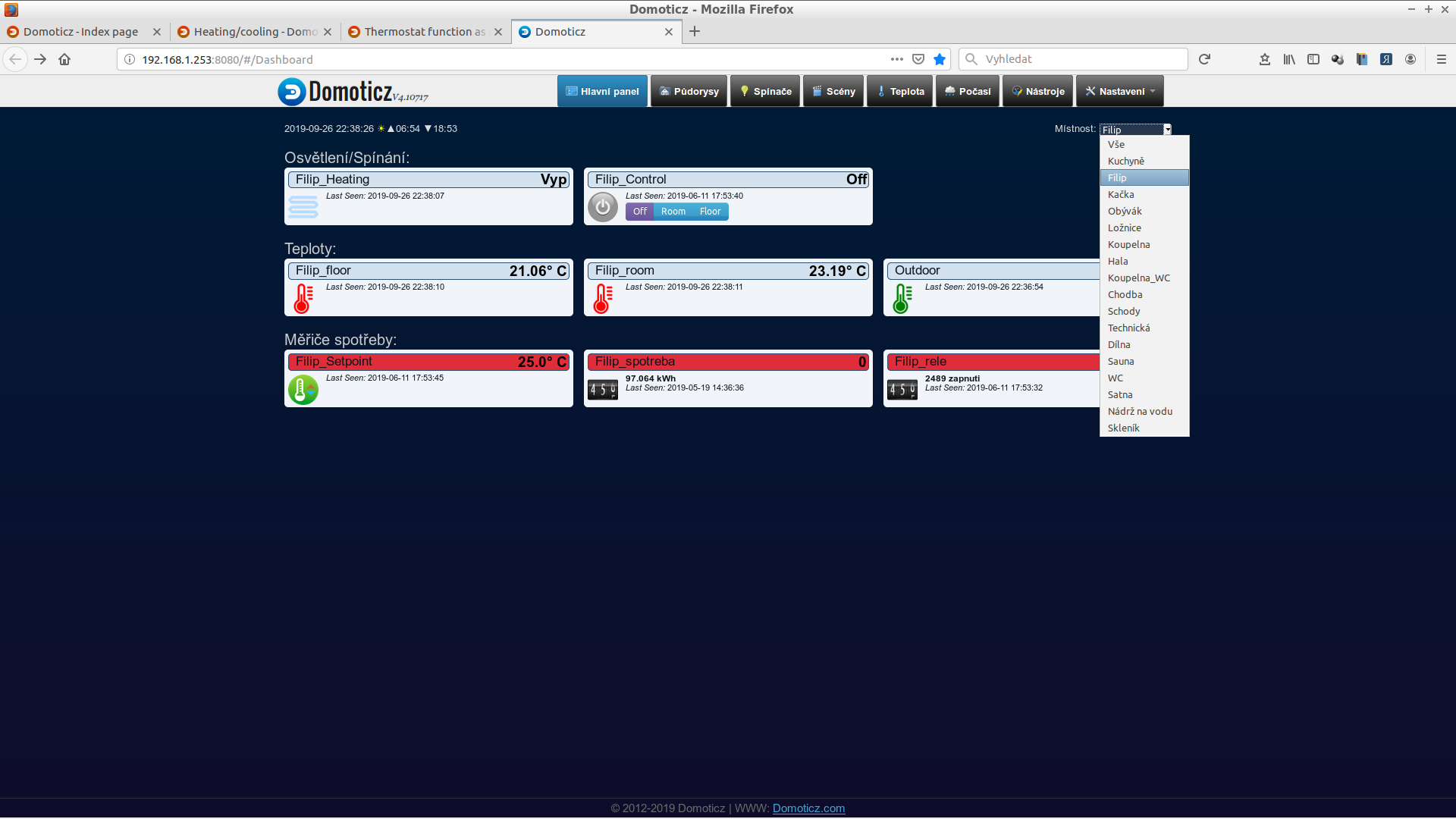

I think there is no such device.
But if you use floor plans, you can see all values in one place simply clicking on room name.
