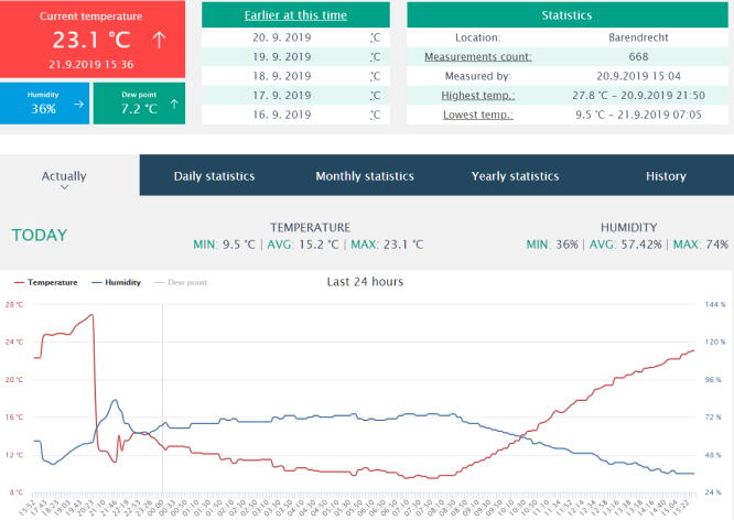

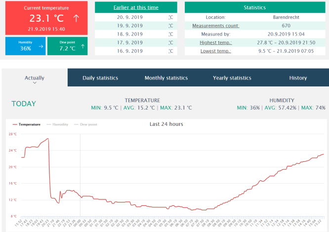

If you click in the legend area on humidity then you will only see the temperature line. (See below)
