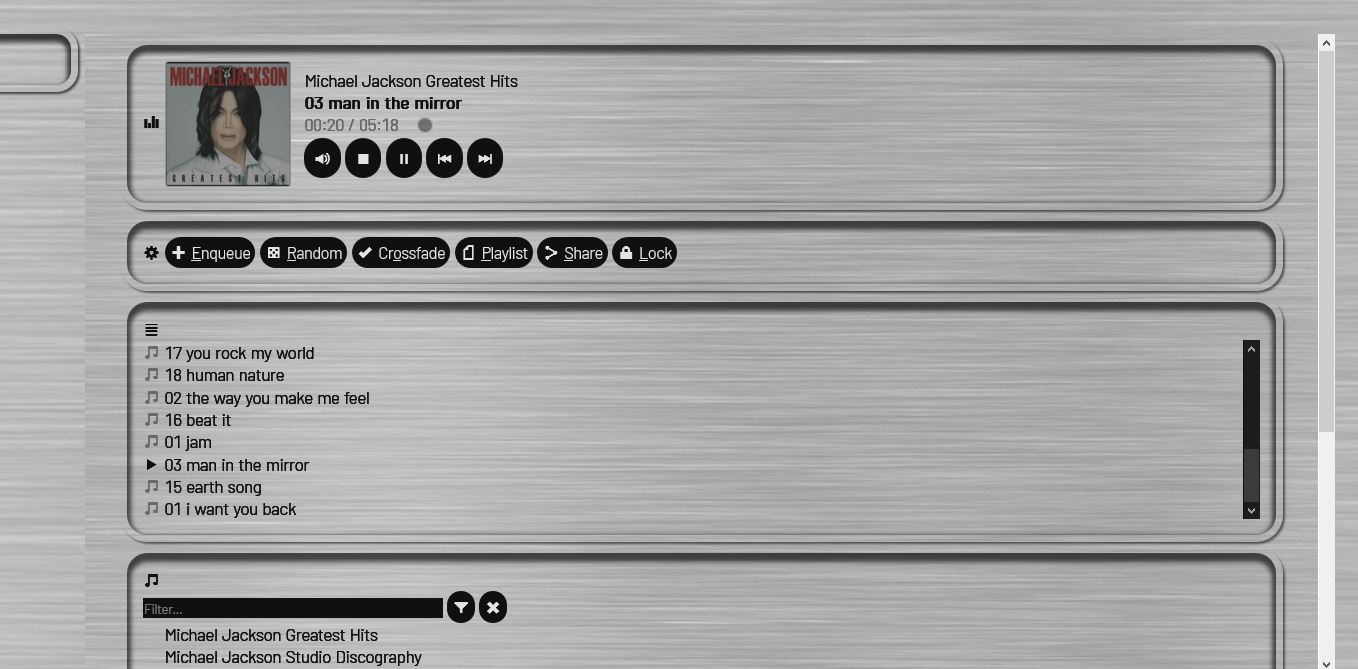

I have created a mediaplayer that streams my music from my nas.
The only problem now is that the frame must be fixed.
I try html,js ,css but nothing disabled the scrollbar.
Can you help me with a code to disable the scrollbar.

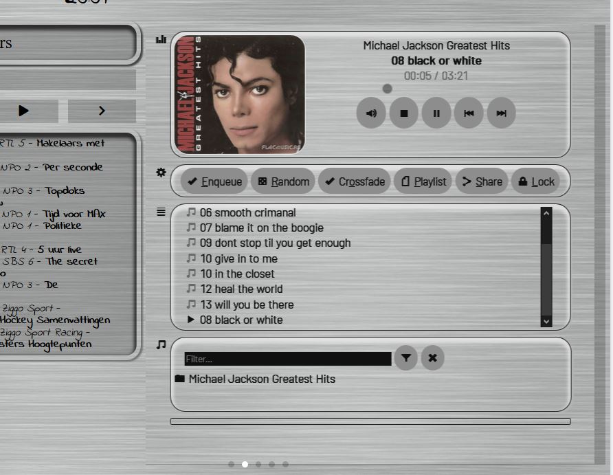

Gianni
- Posts: 230
- Joined: Saturday 21 July 2018 19:03
- Location: Home@Belgium
Re: iframe no scrolling
now it's working

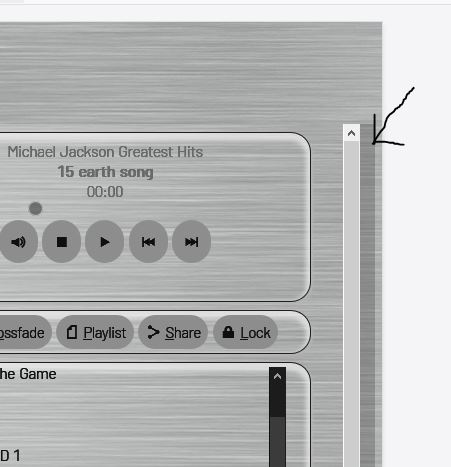

But i notice something else in the frame.
i dont know if it's your or my code but i think its the iframe self.
when you look at the pic you notice a dark bar next to the scrollbar.
this is actulie a div behind the frame.
when i look in the inspector i see ths.
when i remove this
then its gone and my frame is ok.

Lokonli
- Posts: 2296
Yes, the code can use some clean-up. Styling is not really consistent.
I've made some changes to the latest beta.
