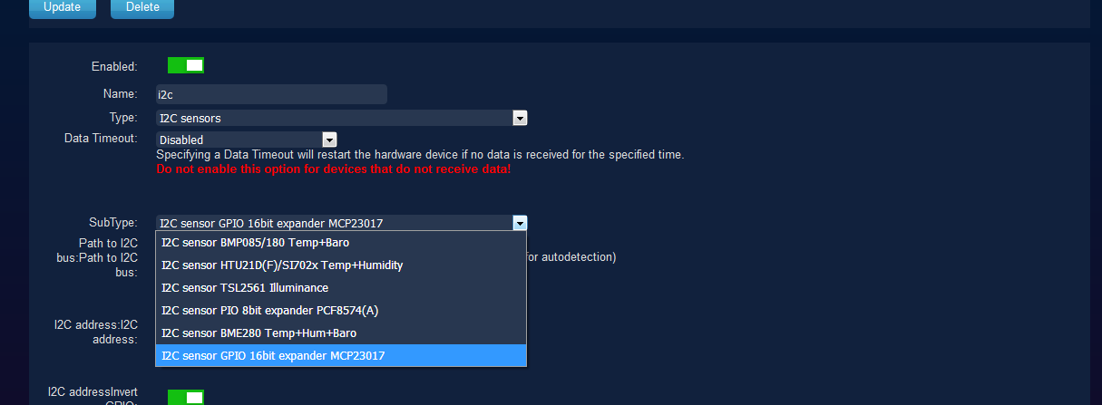

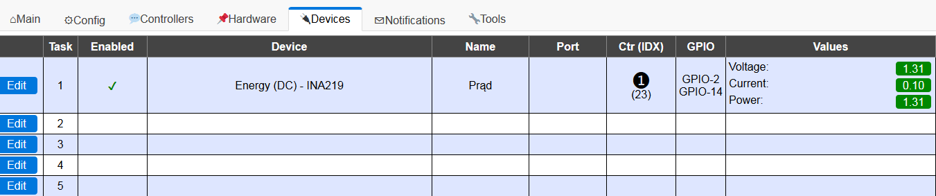

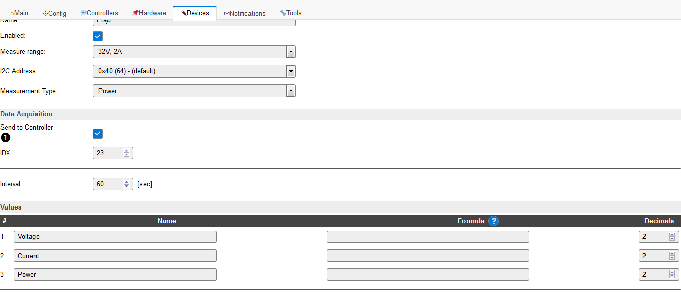

hey, does anyone know how to pass data from espeasy to domoticz for INA219.
Readings in espeasy are ok I have tried in various ways to add them in domoticz but nothing shows
how to read INA219 in domoticz
