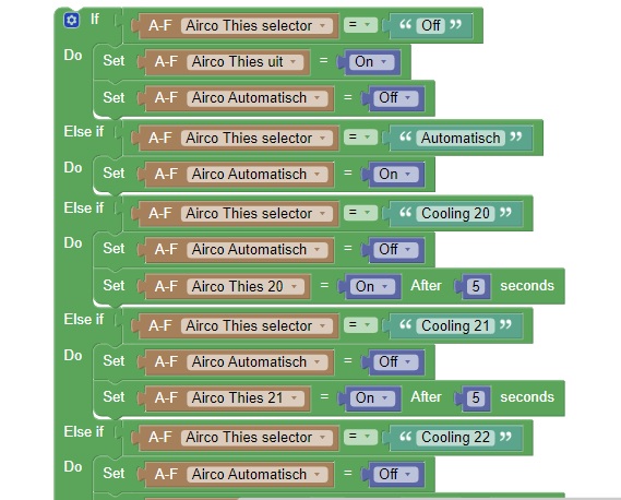

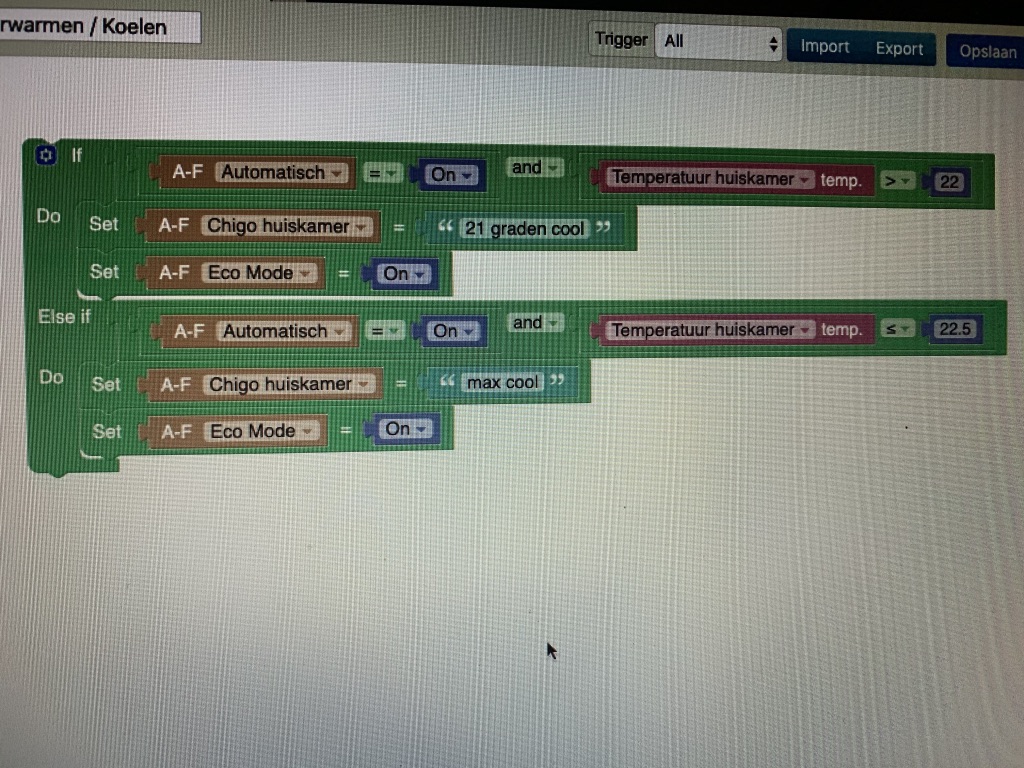

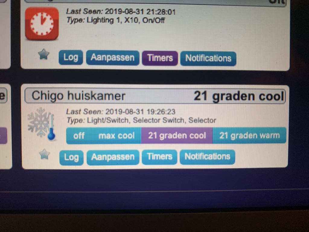

I want to control my airco with the selector I made, but the actions on the buttons of de selector, does not exist. How can I do that action ? I tried it this way, but that does not work. Someone any ideas ?

tozzke
- Posts: 135
- Joined: Friday 02 January 2015 9:22
- Domoticz version: Stable
Re: How to select actions that not exist in blockly
in the do-section you'll have to use the corresponding % (so Set [Chigo huiskamer] Level (%) [10] for 'max cool', 20 for '21 graden cool' etc)
In the if-section you can use the names you gave those percentages

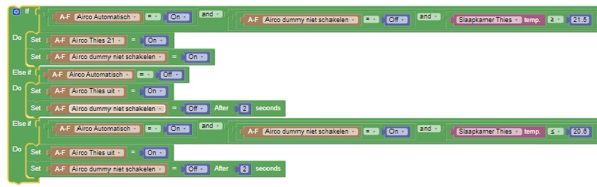

i have this

Thanks for the reactions. You use the selector only as dummy to select a real button in blockly. At my situation the selector is a real selector. It are four learned functions on a broadlink mini.
I want to make a script, that based on several conditions, the selector "Chigo huiskamer" in the right setting switched. Do I have to do that with json ?
