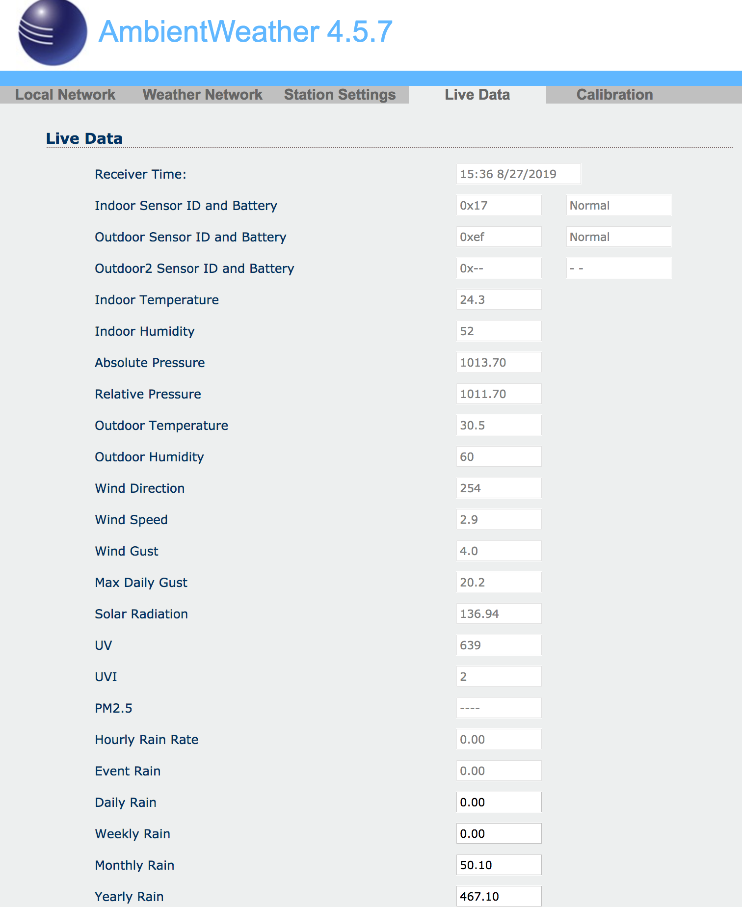

I run a local weather station in my LAN which sends its data to weather underground.
Besides that the weather station is reachable in my LAN by accessing it's webpage.
The data in this pages refreshes every minute and I would like to fetch it directly into domoticz.
The screen looks like this :
Screen Shot 2019-08-27 at 15.36.41.png (279.35 KiB) Viewed 3322 times
Data seems to be plain html like for example :
   <tr>
      <td bgcolor="#EDEFEF"><div class="item_1">Indoor Temperature</div></td>
      <td bgcolor="#EDEFEF"><input name="inTemp" disabled="disabled" type="text" class="item_2" style="WIDTH: 80px" value="24.3" maxlength="5" /></td>
   </tr>
As I am not familiar with LUA, any help in getting this to work would be appreciated.
Eddie.

the problem is NOT getting data from ambiantweather or weatherunderground.
I want to parse the data on the local webinterface of the weatherstation. It contains more info than ambiantweather or weatherunderground.
the local webinterface is plain html and requestable from http://<local-ip>/livedata.htm
That is the screenshot I posted ..
Eddie

below the result of curl http://lan-ip/livedata.htm
<!DOCTYPE html PUBLIC "-//W3C//DTD XHTML 1.0 Transitional//EN" "http://www.w3.org/TR/xhtml1/DTD/xhtml1-transitional.dtd">

as you can see, all rows like
<input name="inTemp" disabled="disabled" type="text" class="item_2" style="WIDTH: 80px" value="24.9" maxlength="5" />
contain data which I would like to use in domoticz. In this line the indoor temp = 24.9 degrees

@Toulon7559 sorry that is NOT what I want. The PWS is sending data to that website and that part works.
BUT, the PWS has a lot more data than availiable at ambient or WU. I want to read the PWS directly. It is far more accurate than ambient or WU

Find below a first dzVents prototype based on test data.
When not yet familiar with dzVents please start with reading Get started Before implementing (~ 5 minutes). Special attention please for "In Domoticz go to Setup > Settings > Other and in the section EventSystem make sure the checkbox 'dzVents disabled' is not checked. Also make sure that in the Security section in the settings you allow 127.0.0.1 to not need a password. dzVents uses that port to send certain commands to Domoticz. Finally make sure you have set your current location in Setup > Settings > System > Location, otherwise there is no way to determine nighttime/daytime state."
1st. step: change your IP to the actual one and see if the scripts executes without errors and save the relevant loglines
2nd. step: (if no errors in 1st step): change testHTM in the 2 for loops to item.data and see if the scripts executes without errors and save the relevant loglines
If anything is not clear yet do not hesitate to ask.

Hi @waaren, tnx for your time so far.
I am currently running V4.11229 on rpi.
Later this morning I will try to implement your script and let you know.
regards,
Eddie

below the result of step 1

after step 2

eddieb
Posts: 391
Joined: Wednesday 04 July 2018 7:48
Re: Get weather data from LAN based ambient weather stations webpage
Post by eddieb »
Looks like it is working, now I should probably define some devices under dummy hardware ...
What do I need to do to get this working ?

eddieb
Posts: 391
Post by eddieb »
Hi Toulon,
the PWS is running ObserverIP software.
It has a local web page with all the info and sends its data every minute to WU and Ambient.
As far as I can see there is no local json available.
(and the api does not contain in-house sensor data ...)
Eddie
