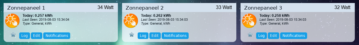

One of the advantages is that you can read the individual power production of each panel.

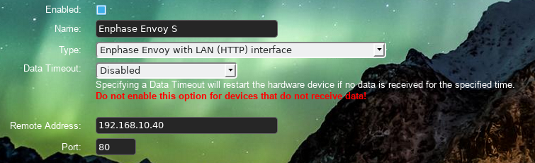

As recently the functionality of the Enphase Envoy-S has been extended and now also support the Envoy-S metered, I suggest that the software for Enphase S is extended once more so that we are able to read the power production of each individual solar panel.
In this case it will give you all the results for the individual panels.
I have made it this way with Node Red and it works fine for about 3 months now.
